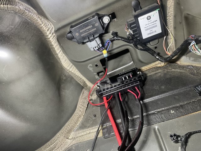

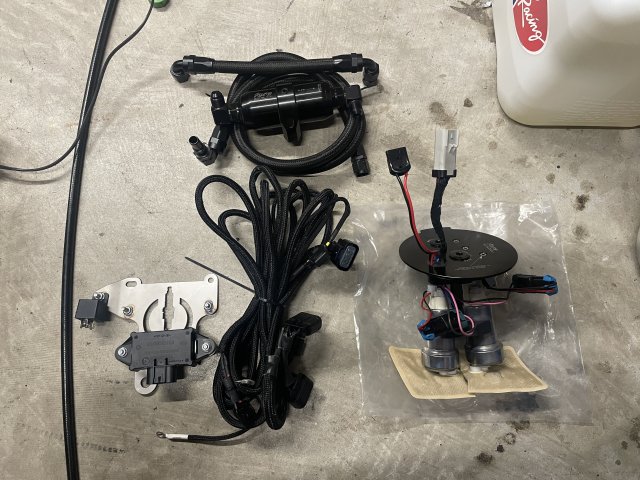

Finally done! Install completed. Need to power up the car and make sure no lines leak, thats a tomorrow thing. Once happy with no leaks I’ll finalize the wiring in the trunk.
FC3 location. Once finalized I will velcro it into position.

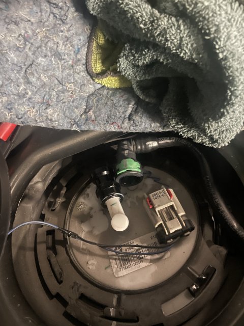

You have to tap pin A on the harness to power the regular pump. Other pumps come on with hobbes switch after 5psi. 6FD05974-E613-435D-AA8A-BD694E0B781C.jpeg

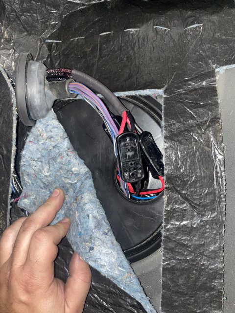

All the connectors are in. You’ll also tap the old harness for the fuel level sending unit. FB0ECA5D-9CBD-4980-87FB-A36B62225609.jpeg

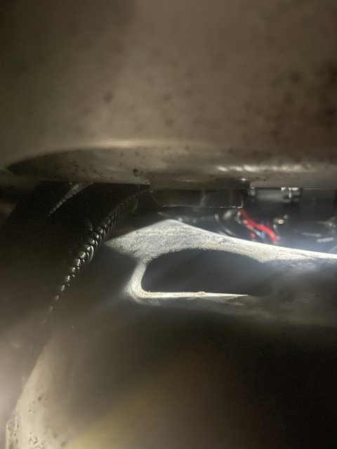

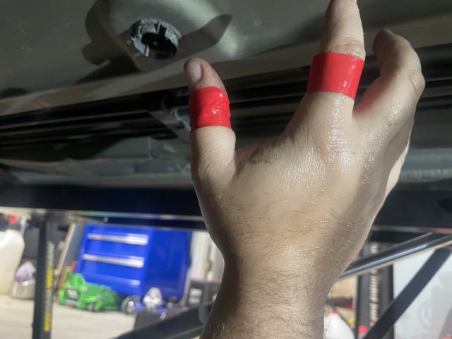

On removing the old OST system got E85 in my cuts. Btw electrical tape works for big gashes… 7963B5CD-9178-4888-A2A7-2C8632C733DF.jpeg

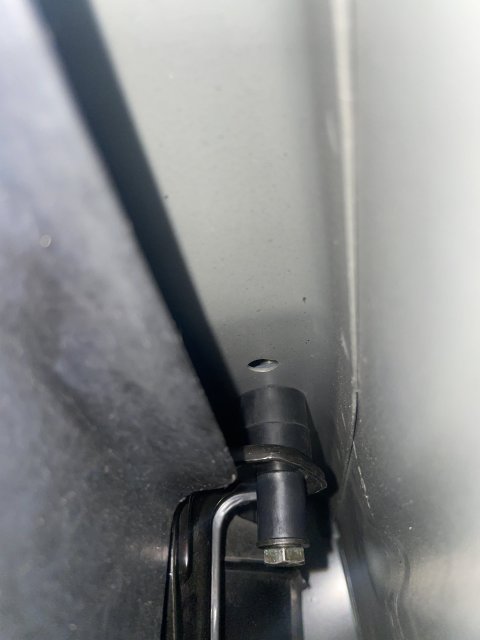

What I did to make sure I was not crushing the lines.
Capped off the old system and removed the line.
full OST plug n play system. What do you think a fair market price would be in for sale?

I think you should put the Electrical Tape on before you work to prevent the Big Gashes ;)

that would be interesting, electrical tape gloves
I'm sure you could event something. :)

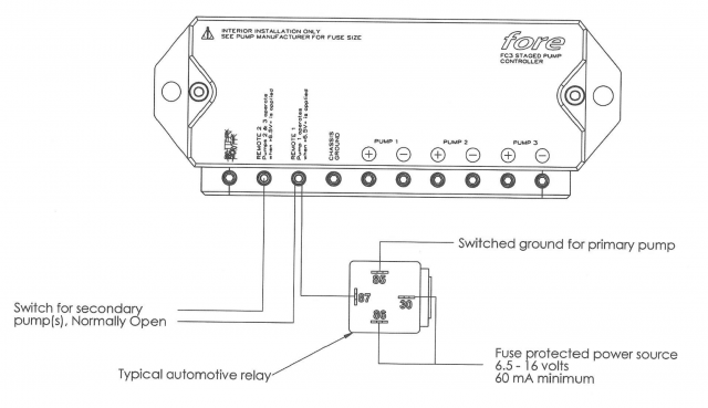

So theoretically I should see 12v constant stream from one of the pins on the harness connecting to the FPCM and this should be enough to be the trigger for the pumps. However when starting the car I never get a 12v power reading on any of the pins. Following the instructions here:
I tapped into pin A and used it in the trigger for remote 1 as pictured here:
However pin A never sees above .23X volts. So I started trouble shooting. Checked the relay, this turned out to be fine. Checked all connections for continuity, everything is fine. Checked power harness for 12v going into FC3, everything was fine. Maybe I had a bad tap, checked the tap and everything was fine. So the only thing I'm thinking of is that the FPCM and pin A, cannot be used to power the remote 1 terminal and that a relay would have to be configured as follows:
If anyone has wired in one of these units before your help would be appreciated.

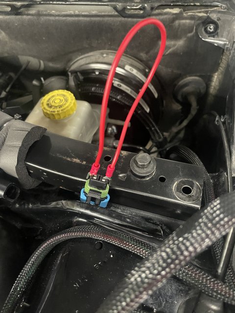

So I spoke with a man much wiser than thou. Turns out my hunch about commanding more artificially in the tune was correct. However here are the steps to set base fuel pressure for MAP REFERENCED CONFIGURATIONS.
Jump the relay as if you were going to empty the tank.

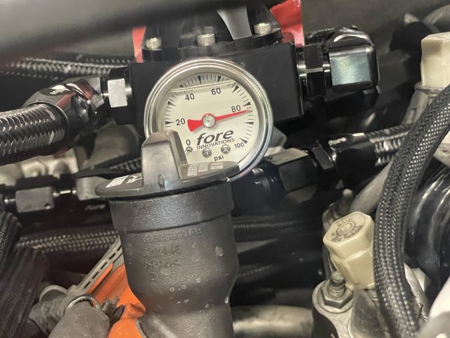

Once pumps are running adjust to desired PSI. I set mine for base + boost, 80psi at WOT according to tune. Then I removed the relay. Then I fabricobbled a jumper to jump the hobbs switch to emulate boost.
With all three pumps running it should only jump 2-3 PSI per Fore’s instructions and it did just that.
From here you back it down to 80psi and set the jam nut. The thing that excites me the most is no leaks.

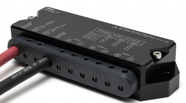

In a level 4 setup from Fore the FPCM does not control your primary pump anymore. The FC3 is the controller found here:
These are the ports on it:
Remote 1
Remote 2
Pump 1 - Pos/Neg
Pump 2 - Pos/Neg
Pump 3 - Pos/Neg
Remote 1 controls the primary pump and uses a voltage above 6.5v as a trigger. Remote 2 controls pumps 2 and 3 off of a 6.5v and higher trigger as well, this is supplied by the hobbs switch above 5pis of boost. Now back to pump 1. The standard installation is to use pin A on the FPCM harness to trigger Remote 1, this is unlike R/T, Scat Packs, non boosted SRTs where there is just the voltage supply and that's that. The FPCM is a PWM based unit and I believe I was mistaken in what I said before but pin A is not PWM a different pin is (I believe it to be pin D). The issues I was having was setting the base pressure was due to the following, me thinks...

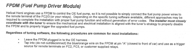

The fuel pump relay is controlled by pin 73 the "FUEL PUMP RELAY CTRL" (FPRC, cause typing). When you put the car in RUN, this pin is energized thus powering pin 86 on the relay, thus activating the coil, but it only happens for a second. So Fore's instructions to put the car in RUN to set the base pressure is false, severely false. So to simulate the fuel pumps being on you bridge the relay pins like you are emptying the fuel tank, this allowed me to set the base pressure (for map configurations that's base + boost = 80psi at WOT). Then from there I bridged the hobbs sensor and adjusted as normal.
The reason I was concerned about the FPCM is because I believed pin A to be PWM but now after looking at all the schematics I understand all the pins on it and do not believe pin A to be PWM but just the relay is not energized by the PCM. However a man much wiser than me said that I may need to command more PSI:
If using pin A, you'll have to adjust the tune so that it provides more consistent voltage to the FC3 controller while the car is actually running. Stock settings will downvolt when pressure is higher than it's targeting for whatever condition. Set desired pressures higher than what you expect to see under different loads.
I think this means that the relay could be turning on and off to drop voltage if it isn't necessary. I will monitor the situation with logging and report back.

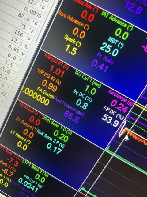

We have lift off. The map reference config worked. Set to 80psi on setup, then vacuum pulled it down to approximately 66 psi. Im okay with this. Now to drive around and test it.
