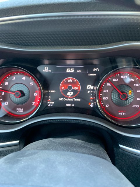

I have some distilled water and water wetter, has anyone switched this out in their killer chiller in their supercharger or should I just experiment and dilute the stock 50/50 mix and to get it to 70/30 with water being the dominant item in the ratio?

With a chiller, I wouldn’t run water without some sort of coolant mixed in to lower the freeze point.
Here’s why and also note that temps measured at the ICT sensor will be warmer than in the chiller itself.

Ah, excellent call, I forgot all about that chiller! Some math for mixtures and freeze points will be needed to find the minimum anti-freeze to water ratio for the temps you see, and I'd obviously error on the conservative side.
Yeah definitely don't want to do that.
Stock system takes 4.5 quarts,1.125 gallons, the BMR tank adds approximately 1.5 gallons. Total 2.625 gallons all together.
1.3125 / 1.3125 is the 50/50 mix. To convert to 70% water 30% coolant as per Kincaids directions I would need to get to: 1.8375 / 0.7875
1.3125 - 0.7875 = .525
So remove approximately half a gallon of coolant and replace with distilled water.

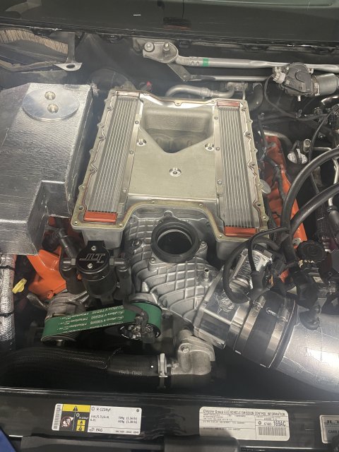

Put on the badass bypass valve.
However now I cant get the supercharger to line up.
im about to roll it out the garage and pour gas on it and be done with this shit. Why does it fight me on everything.

Lid or main bolts? If the main ones then it would help to take off the belt.

Yeah thats what I had to do in the end, came back here and saw your post. Thank you… Im such an idiot sometimes. I think this car has just drained/fatigued me this season and Im worn out. Keep spending money but to don’t go faster. The pure definition of insanity.

It’s ok, ask me how I know. 😂
Made the same mistake myself once upon a time ago.
