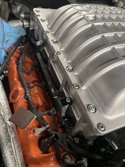

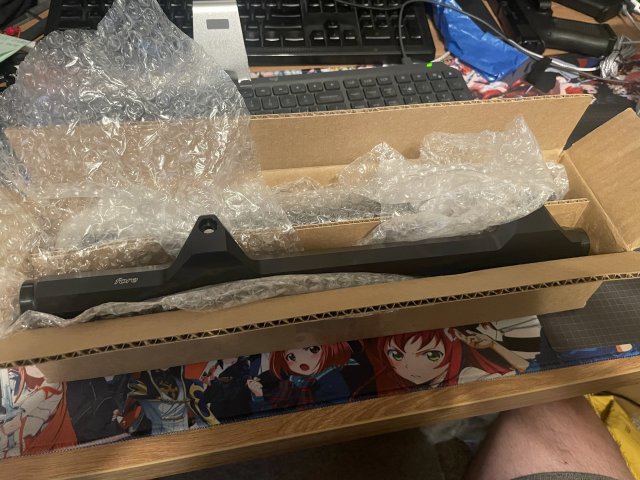

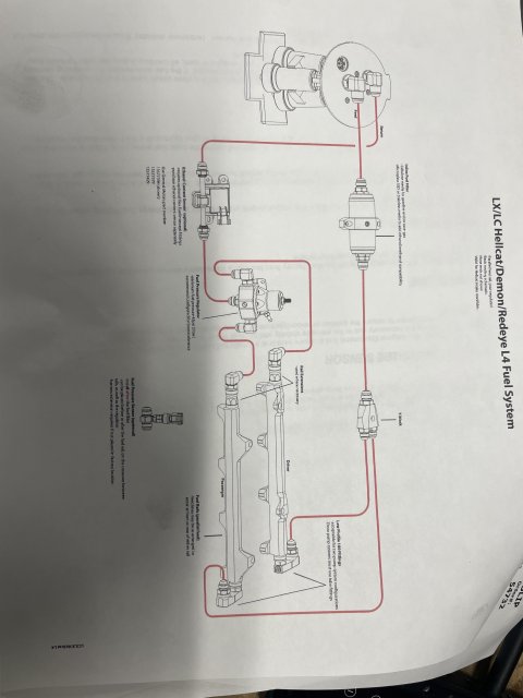

Some progress was made, however the instructions kinda leave me scratching my head. Got the rails and injectors back on.
950A96A2-2670-44D7-BA3F-610E00812C2F.jpeg 70F9B2D1-94EB-4F8C-B845-C7F0C5390163.jpeg
however the instructions have me perplexed. I cannot use the 180 low profile per fore
they want you to go to the front of the rail the at the back of the rail hit the regulator…
if anyone that has the L4 setup want to post pictures it would be appreciated, im currently scouring google looking for examples myself.

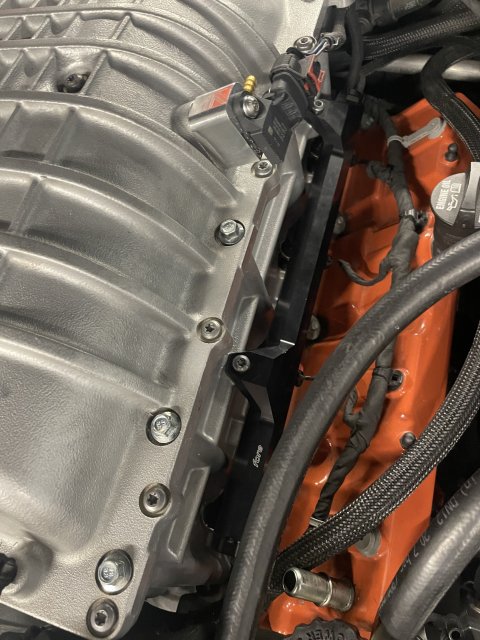

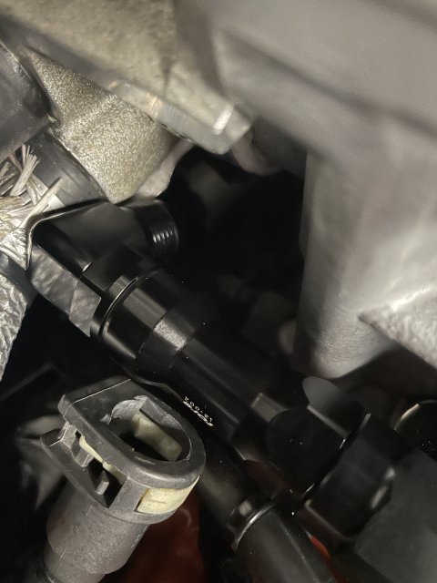

Well this is how I have it now.
3E447BA9-4B2E-458E-8E52-5A4DAEB1634B.jpeg B73C6CBC-C8F2-4A4F-A3F7-1396EEA3CC80.jpeg
there is no way in hell you can get an a/n fitting on those threads, either the kit came with the wrong pieces or is missing the fuel rail extensions

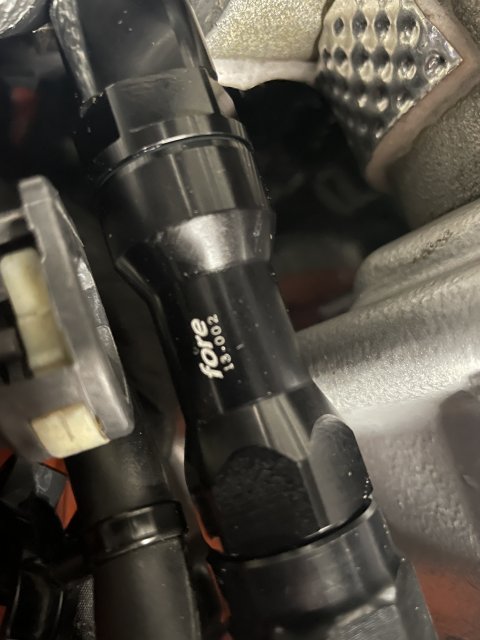

218,486
Yep got the wrong ones, was supposed to get a 1.25" extenstion here: https://www.foreinnovations.com/product_p/33-016.htm. Instead I got these: https://www.foreinnovations.com/product_p/13-002.htm which is why I was confused AF with the kit when laying the pieces out. I'll call fore/hhp in the AM. I'm tried, I can't even get a fucking peaceful relaxing fuel install, nope just have to get the wrong fittings sent.
some projects are challenging enough you don't need them to mess up the parts:mad:

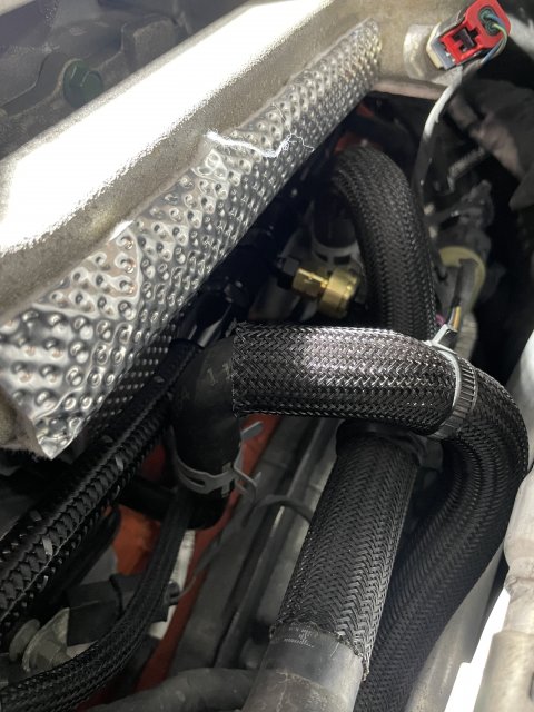

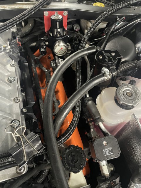

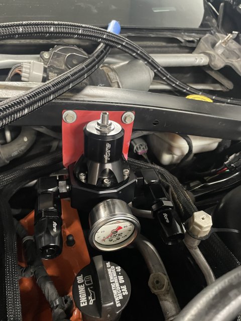

Okay so decided on rear of the rails is the feed and the front of the rails is the return. Mapped put the returns as I have quite bit to do to run the Y block. First where I mounted the regulator.
then did a mockup
return to regulator
rubber hose clamps will be procured for the lid to keep it tight. The final piece will be a small section of hose for the driver side return
and plenty of room for the feed to dump, will be wrapping the dump port in vibrant heat shield till it exits the engine bay.

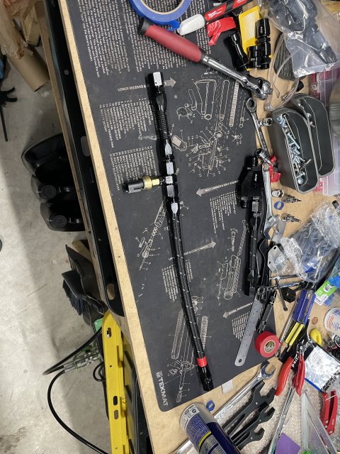

ive never cut flex lp hose before so tomorrow ill cut and hopefully not ruin any an fittings 😭🤭

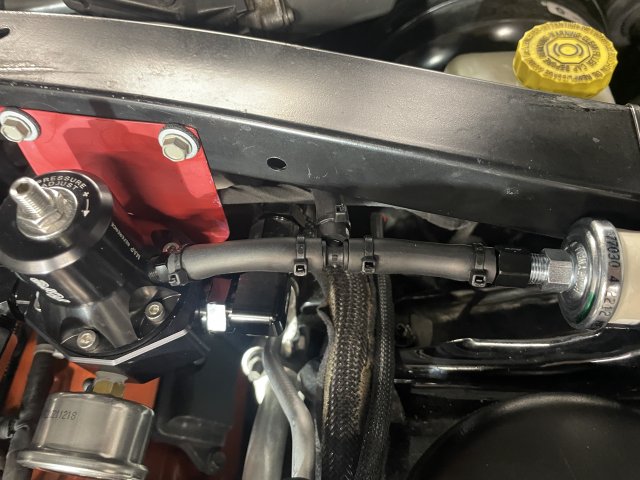

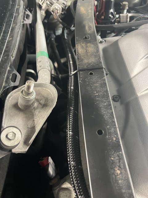

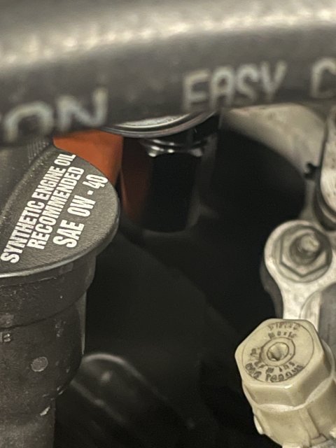

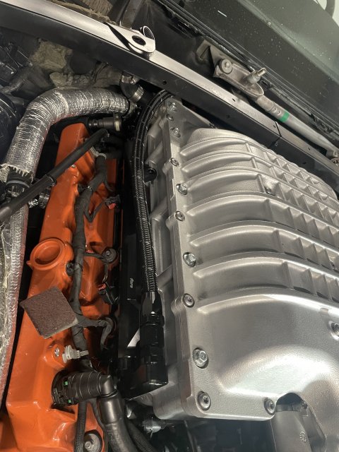

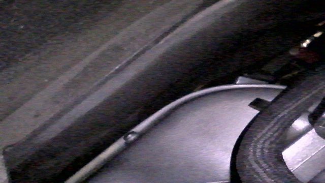

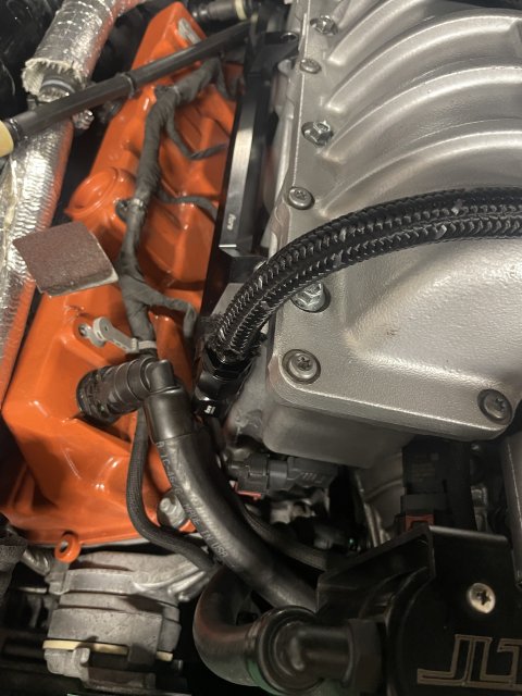

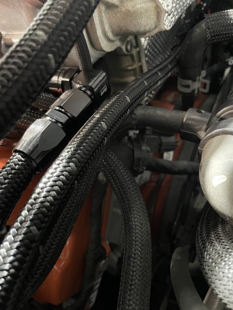

Over the supercharger mount was not gonna cut it. Decided to close the hood and boroscope to see how much space i was working with. Not a lot.
C6F92E6A-41C7-41F4-B4FF-753D3290B47D.jpeg Stared at the motor a bit and found running it behind the SC was the best option.
using a trusty ziptie to keep it off the SC and away from the wiper motor.
then just oriented one of the arms backwards
pretty happy with result, hobbs switch was temporarily mounted and ran all the map pressure lines to the regulator.
making progress! Up next is the feed to the Y block and then the return. Tomorrow im picking up a ORB to AN 8 90* fitting. Not a fan of the height to the valve covers.

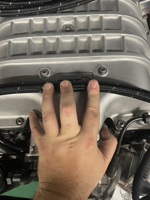

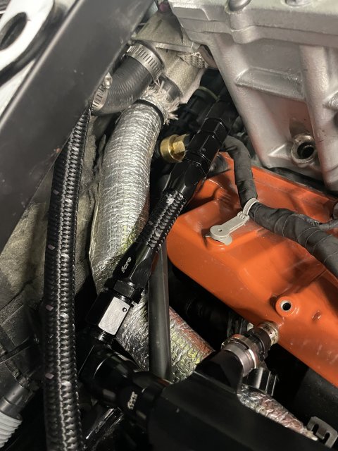

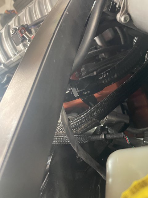

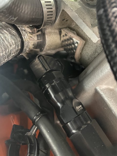

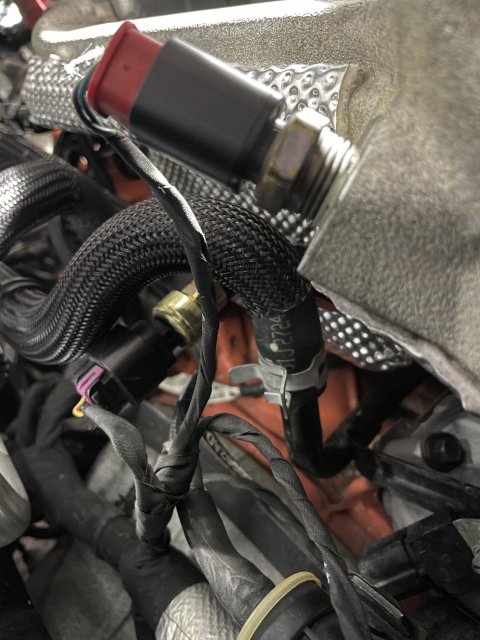

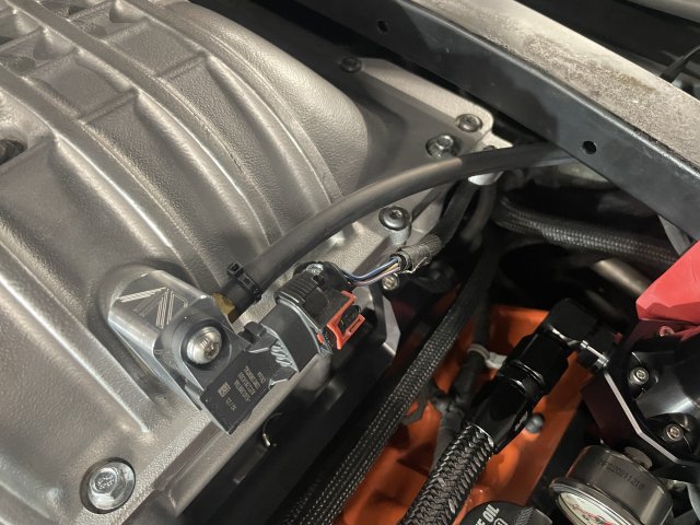

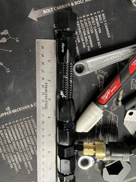

For anyone doing a level 4 kit and using the OE sensor location I am going to save you a lotnof hastle. 4 inches, no im not talking about why your wife/gf/whatever is disappointed… Im talking about this…
E380F5AC-C5F2-40AC-B765-AEA8BDAACD30.jpeg 0330FE3A-26BD-42E6-9BE8-59FD7433D0C0.jpeg
From compression nut to compression nut that’s the length you need to accomplish this.
712603B7-8C76-40F0-8672-206A35C8BA47.jpeg The only other gotcha is you will have to remove the fuel rails starting on the passenger side due to the tetris you have to play because you will have to pretighten the AN fittings. You will not get a wrench on them.
Otherwise everything else is fit and finish, measure twice, cut once.

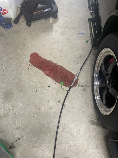

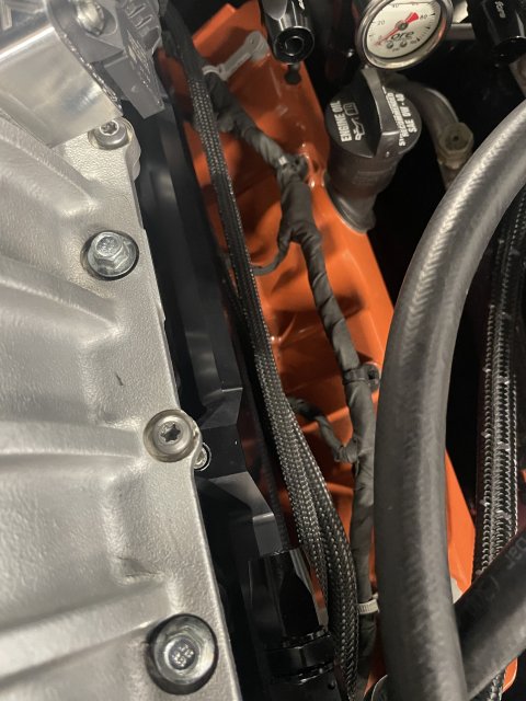

Not a lot of progress really. Got the triples in and the return run.
A86B02AE-8BA3-4CFF-8DB6-DCBA6A481AD7.jpeg BC580A39-A7D8-4FCB-B663-EF4C49F86738.jpeg

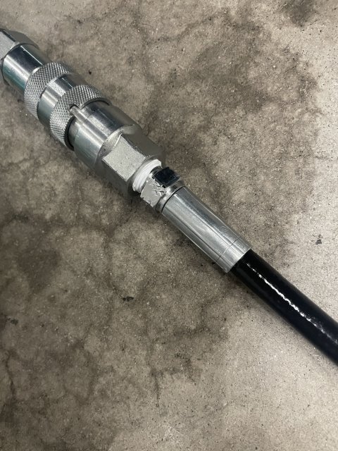

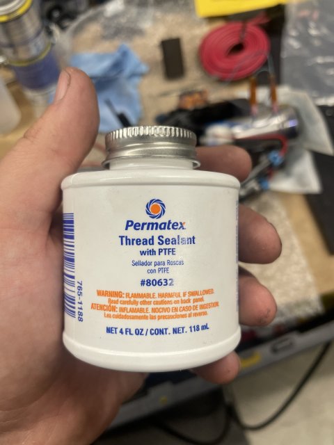

take note of the feed not being straight. Well come back to that. Had a osha violation, fitting failed while under the car on the quick jack. Heard a pop and ran like usian bolt to a safe spot.
frantically got wheels on and lowered it. Took the fittings apart, cleaned them, used this and some teflon tape, back in action
05981831-A8EC-4D5A-A714-8C59BCEE719B.jpeg C17299DC-A644-4FD9-8CCD-2D2E28524B96.jpeg
no leaks since…

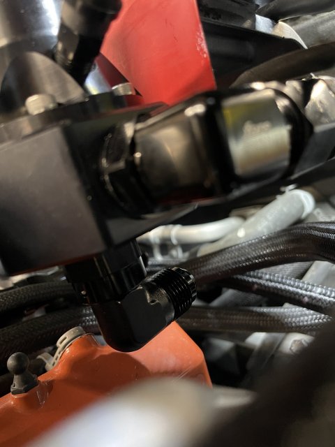

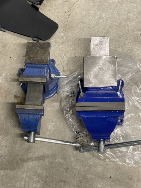

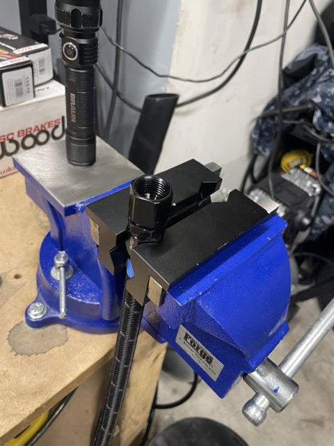

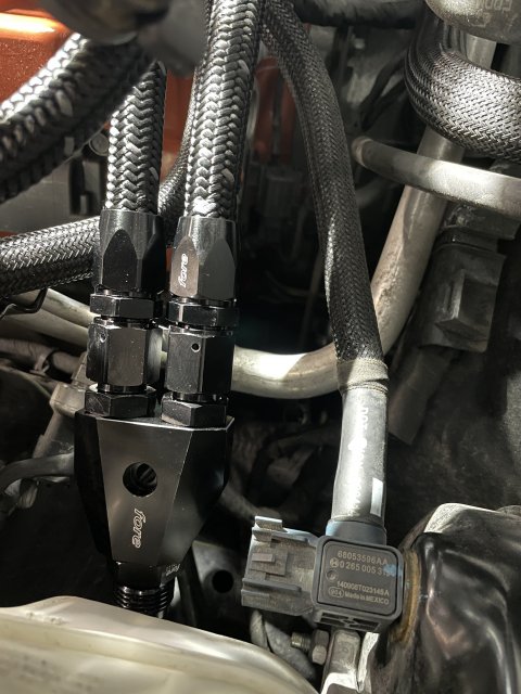

Now getting back to the 45* fitting, fuck no, you have to lower the tank to get the hoses in and that 45 wont land the hose where its needed. Solution: take the -10 at the y block and just switch ends. Its perfectly fine for the 45 to hang from the Y block. Cant tell if fore ran out of fittings or if they are fuckwits… anyway return is run, however im smoked… did upgrade vise for making more an fittings
CAD7D465-2B93-4955-B564-EC6985B2F889.jpeg 8E24FD9B-820F-4A0A-A225-AAC89A929300.jpeg
was really hoping to be on wiring already but it is what it is.

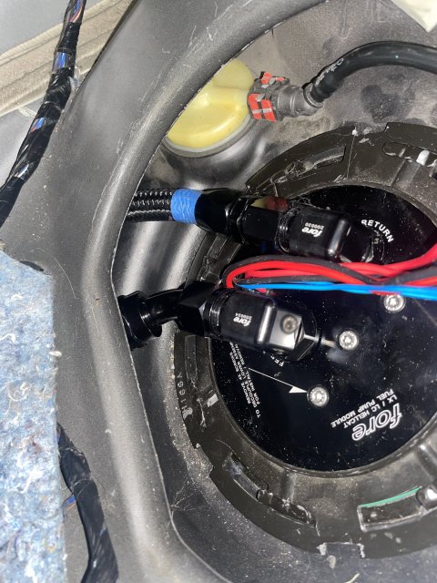

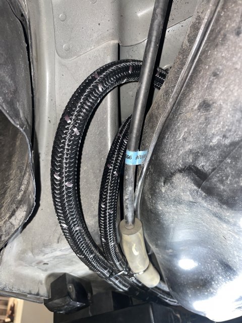

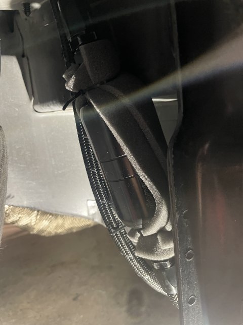

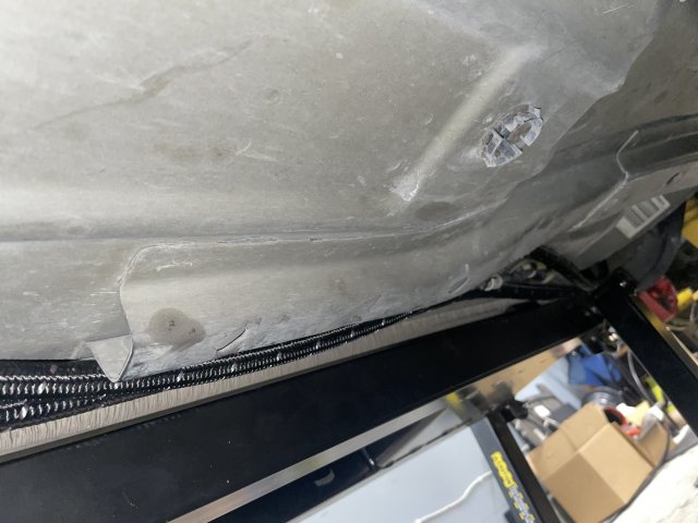

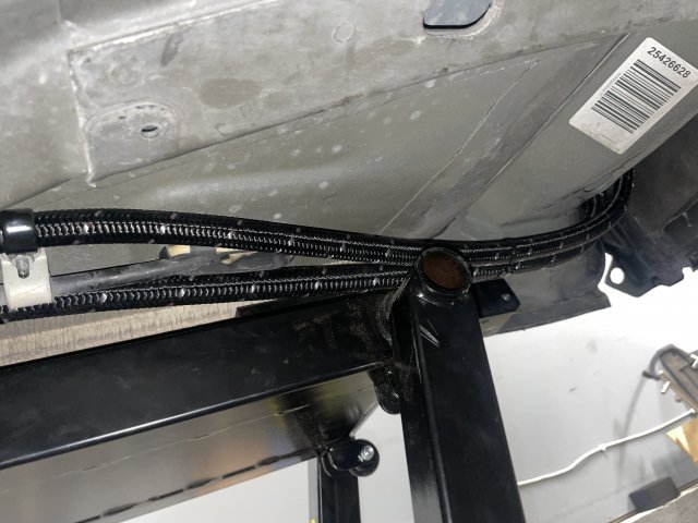

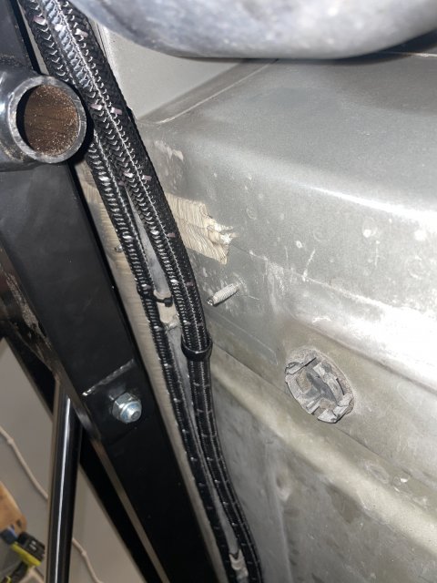

Decent progress, found that the 45* -10 fitting was a better option than the straight -10 over the fuel tank. However the fuel filter, yeah… this is how low it sat.
thats one speed bump away from a bad day. Instead mounted it in front wheel well.

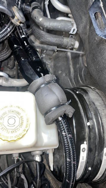

Finalized the lines, one was too long and had to shorten it.
After a few connect/disconnects. Decided to move one of the lines over the master cylinder.

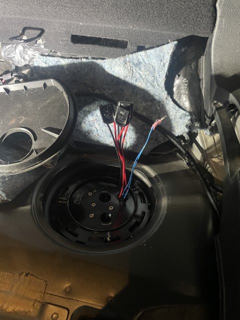

tomorrows activities will include disassembling the existing OST harness and fpdm and wiring in the FC3 for Fore. Fun times!

At the Dyno shop Saturday with my friends a guy was there who just redid his fuel system and he said within 2-3 days running 85 it leaked everywhere he used Teflon paste he had to take it all apart and use a special paste designed to handle the alcohol content in E 85
