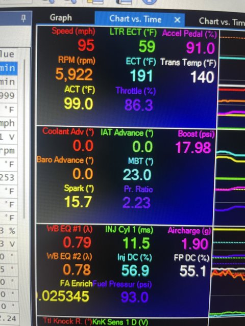

went to mexico, fuel pump duty cycle never budged… injectors never went above 57%. When the car says it wants to skidaddle, Im along for the ride… fuel trims are scarily on point…

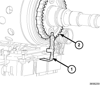

So I looked over the logs, it looks like HP tuners threw a hissy fit during recording. Hence why I have a nice horizontal line across the log that is not indicative of anything. I reverted the tune to the stock hellcat tune and drove for a while. No codes till a little bit into driving. the P215C came back on and this is labeled as the following in HP Tuners: Output Shaft Speed - Wheel Speed Correlation. Upon googling on the other site it seems the only thing that fixed it is putting a new trans in. This is really disappointing cause that means the trans is on borrowed time. So to dig into it further I learned that I get free Chilton access through my library so I fired that right up. Learned the following:The OSS (1) is located at the back of the TCMA and reads output shaft speed from the P4 carrier (2).
So two competing thoughts here, the sensor is toast, has dirty/grime on it or got cooked. The next one is the P4 carrier is somehow destroyed and the hall sensor cannot read it due to whatever is wrong with it. So here is the diagnostics testing procedure:

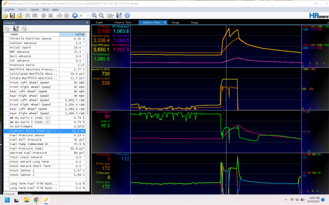

Can someone help me make sense of the math behind the wheel speed vs oss speed?
I've attached the log, I did some online calculators and everything looks fine, unless my tire diameter is set to something wonky.
