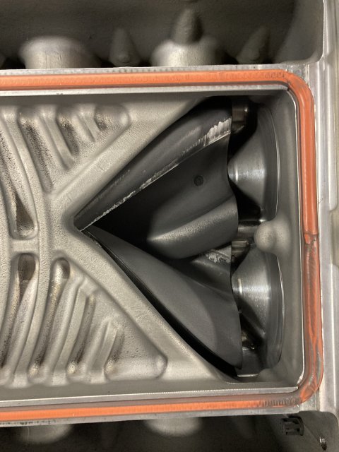

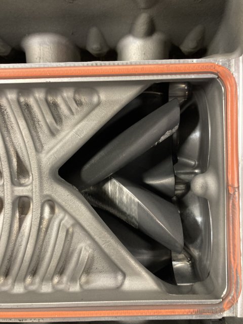

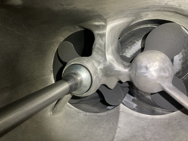

Yes. We only use the +10 balancers.
My last Gen 6 3.8 lasted less then 100 miles, 3-4 street pulls and 3 4th gear dyno pulls and the rotors ate each other and the housing this time too!!
+10 ATI lower and 3.50 Satera CLUTCHED UPPER PULLEY and it still failed!! Dusted my engine so bad with aluminum dust the oil sample analysis drawn with oil the that only had 100 miles on it as well picked up the aluminum in the oil!!

Id have burnt HQ to the ground after that.

That’s when I threw in the towel with Whipple, I sold the warranty replacement while it was still new in the box.

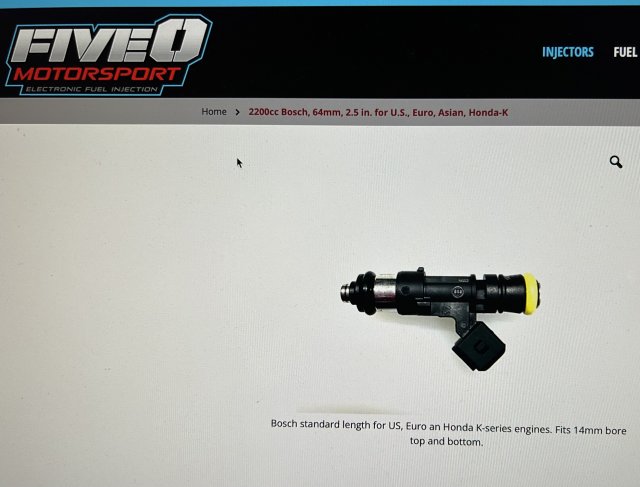

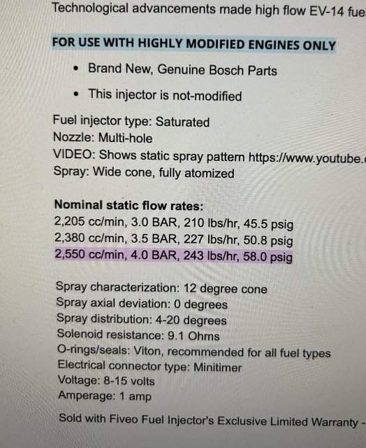

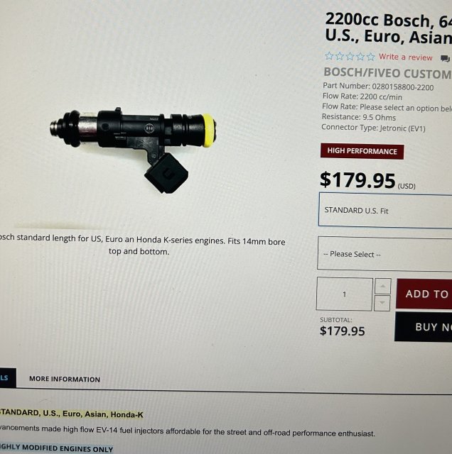

Like @GNBRETT said the 3.8 matched to a 426 with Thitek heads will require a ton of fuel to make the power you want to run fast at the track. Now knowing how HHP operates, if your going on race fuel instead of Ethanol, what you are asking for is easily obtainable with way less fuel system. you could run a set of 1300's dual pumps, the 4.0 upper pulley and 93 for the street. then put Q16 in the tank and put a 3.25 upper making 26-28psi for the track. But be very aware Q16 is more than 10 times the cost of E85. Q16 is $30 a gallon. E85 is $2.99 a gallon.

I'm beginning to wonder myself if I would rather pay for the fuel system or the cost of fuel. Either way they have you by the balls.
The injectors alone are more than double what my dual pump system cost originally. Oof.

Will need at least 2150's, triple pumps, and 2 baps.
