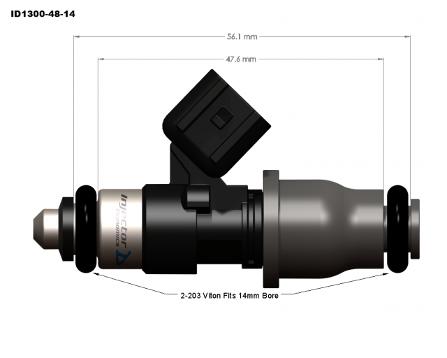

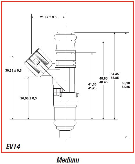

You sold me, what model number are the 2200 cc injectors? The photo you posted? I get screwed up on the terminals and needed voltage for the correct injectors (I don't want to order the wrong ones).
I have reviewed these injectors: https://www.fiveomotorsport.com/fuel-injectors/2200-bosch-64mm-usa-asian-fit/#additional
There is no published data on them for the Hellcat so using them with a stock PCM will be iffy. There is a chart as an image for that injector but it may not extrapolate into anything useful.
In regards to dimensions/risers.
@Marc W injectors size:
Injector Dynamics
They may be just fine using rails for our platforms in mostly stock applications. @Marc W is probably going to be running custom rails cause he's a baller like that 🤣
In regards to the original injector from bosch these are know as #210 injectors. 02801588XX is the prefix for a few different variants. Truth be told all of them have one thing in common, not compatible with Q16. MBTE is present in these fuels.
3,505
11,287
I was using them with the Whipple DragPak 3.0 that you have and the Holley Dominator. Their rails also. No mods necessary there. Just out of curiosity I will ask Adam just to make sure if he’s using the FIVE0 injectors on all the injector upgrades he does using the OE computers. He apparently likes tuning them. Watching what he’s doing with my tuning, he’s never complained that they ever present any difficulties. In fact he has commented on how reliable they are. Of coarse every tuner does stuff differently.
