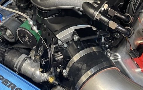

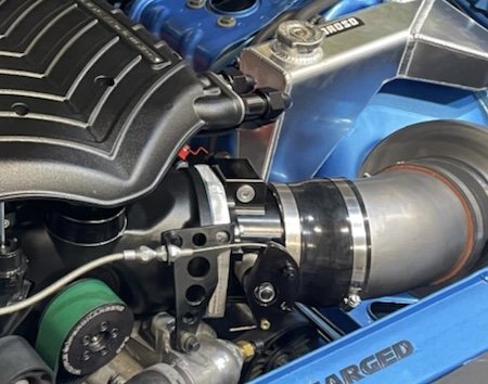

So what is the hot rod kit? Sounds like you need to have a 3.0 to add the 3.8? So selling the 3.0 you would not have an install kit to sell with it?
No Tb no fuel fittings no air intake system
Need to buy adapter to for tb. And fittings
We fabricated all that. C19E263E-ADA1-4C17-96E3-65BC21698F53.jpeg 239129CE-6F77-4CA4-85DF-5BE608913C38.jpeg
