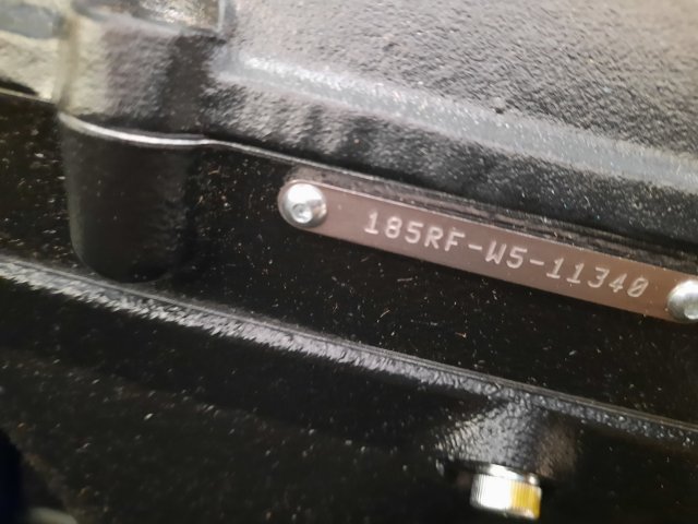

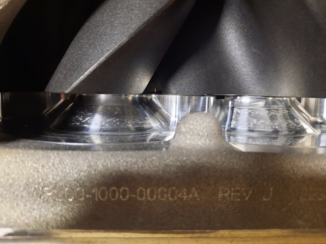

A 3.0? Be curious to know what Rev they’re on now. Please post picture of it, it’s on the back edge on top by rotor discharge. Last one I saw was a Rev J.
is this it?

It is towards the back may have been on the inside. Will be a letter mine was J

same here rev J

July 28th 2022. mine is rev. J
