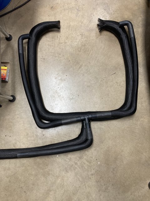

Who would think you could spend 4 hours on insulating 2 coolant lines lol. Was tough getting that 7/8 ID foam over that over braid on the hoses but I didn’t want to take it off, I will give a air gap between the hose and the insulation ID and add a tad bit more insulating quality to it all.
