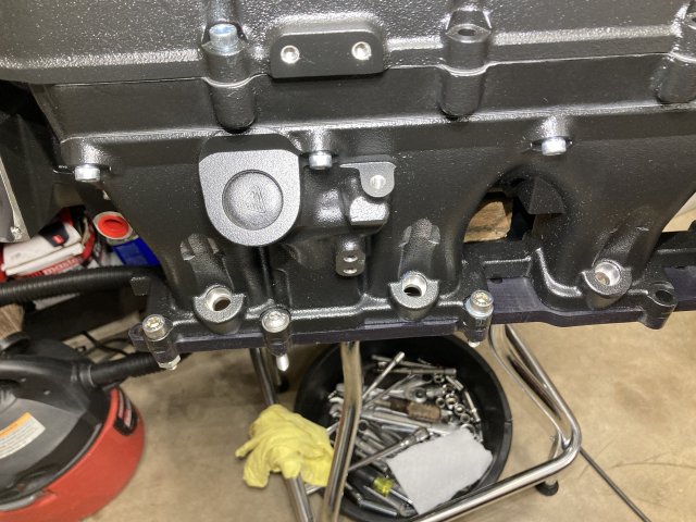

So, Stainless Button heads or Socket heads to bolt it down with? I say button heads.

Both styles look good, but the buttons look sexier

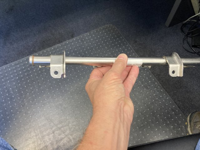

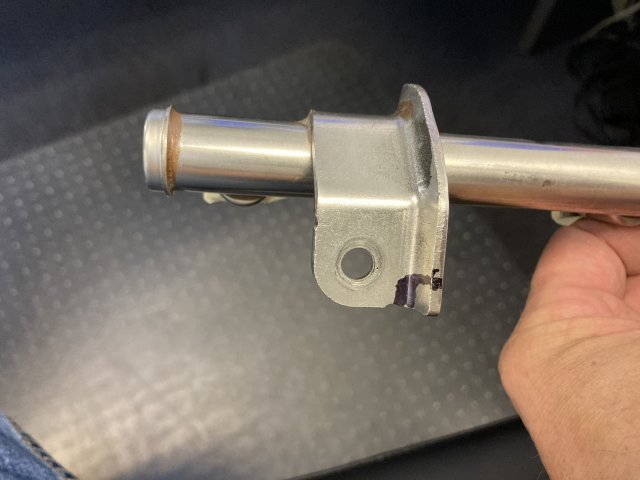

Here’s what needs cut out of the stock drivers side fuel rail mounting bracket, the instructions show this needing to be done as well.
