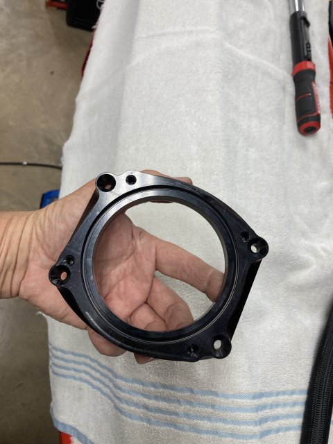

Problem 1, TB adapter is sized for stock TB, They say it’s ready for up to a 108 TB, I guess only if you have your own lathe LOL. Guess I know what I’ll be doing at work tomorrow morning lol
Taking it out to the outside of the factory Oring groove, which will open it up to 107.64 mm leaving hopefully the black anodizing in that area.
View attachment 79841 View attachment 79842
Saw some were boring out the adaptor. Are bolts missing off the lid?
Yes, I will be boring the adapter out tomorrow to 108 mm. They only put a few bolts in the lid, it has to come off to install something inside. I color scanned the instructions with the intent of posting them but the pdf is 75mb in size, can’t even email it :(.
