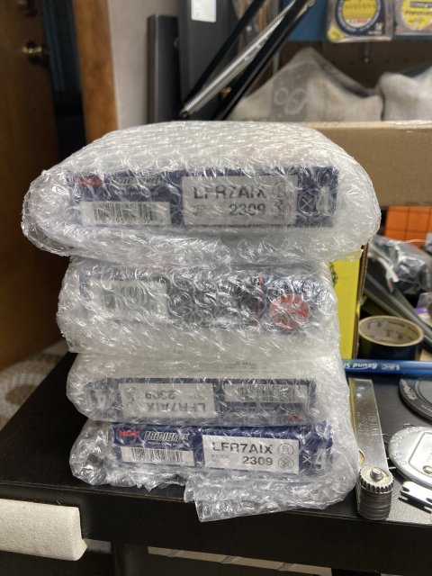

Speaking of fuel system, new fuel pumps arrived today.
Along with a 3.00 pulley a buddy of mine sent me and that bracket from Nitrous Outlet for the insulator spacers. On Sunday!!
7B7C394D-F95B-4E70-978E-ED7CAE3C79D7.jpeg C72E9318-E909-48CD-BD24-72D1D0512349.jpeg
And 16 new plugs too!! :)

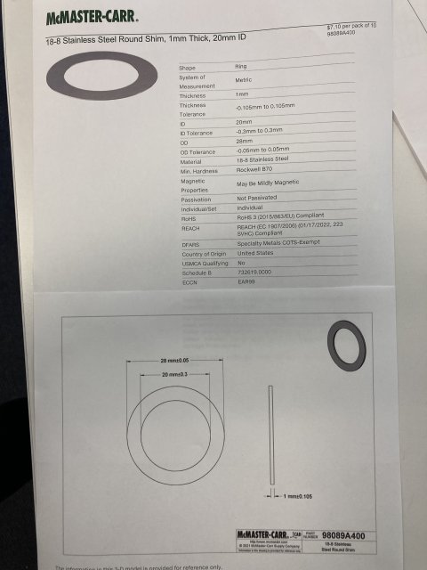

Those spacers for behind Litens pulleys, McMaster #’s below
F5C2E718-3CDA-4A84-884B-B989C2B16B28.jpeg C46D63F5-ED67-4805-93D7-26C2D7902C70.jpeg 5C1924D3-FAA6-45CF-8C10-442CD461E9E9.jpeg
