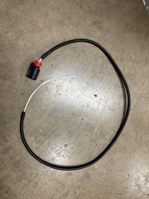

Short coming in their kit. They give you a harness extension because the supercharger intercooler temperature sensor is in the front now not in the back of the SC so they give you an extension with instructions to cut your original plug off your wiring harness and solder on this extension, well I just couldn’t bring myself to doing that. They should have just made a complete plug-in-play harness I mean how much does a plug cost? 10 bucks if that? Well it cost me 35 because I bought a new temperature sensor put the new one in the supercharger and cut the guts out of the old one and made my own plug for a plug and play harness. 1 unplanned hour of today gone but worth it.
