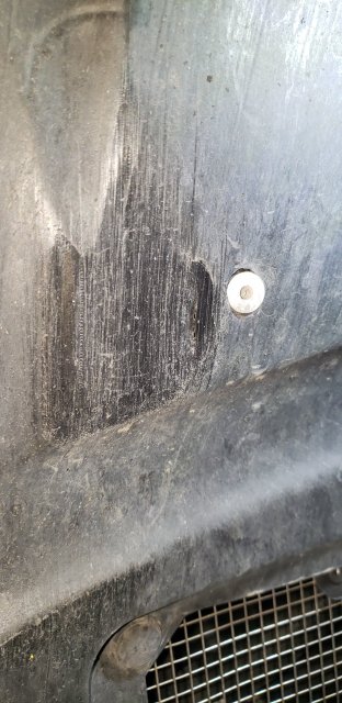

Yes, the 315/35 PS4Ss rubbed on the center of the front inner fender liner, just a little. I assume on track, as I never heard it rub. Left side slightly worse, both rubbed the heads off those plastic rivets so I replaced with aluminum. Might've been worse but the OE upper arms didn't hold camber so the outside shoulders of the tread were destroyed pretty quickly. Again, not sure when it rubbed, just know it did.
The 315/30s have not rubbed that I can tell.
I wonder if anybody has tried 325/30s on OE rims and to what effect? I'd be in for those if no rubbing! 20220302_180305.jpg 20220302_180407.jpg

325/30’s work on an 11” wide wheel gapped out 1”
325/30’s work on an 12” wide wheel placed at the OEM backset position
Then I am going to say a 325/30 has not a problem on an OEM 11” wide wheel placed in the OEM position. They don’t look too bad on the 11” wheel too.
Because?
305/35= 28.4” diameter. —- it is tight to begin with
315/35= 28.7”
325/30= 27.7” ——— see why;)

You guys want to know what else fits?
Take the wheel and crank it left or right. You will find the outside edge of the tire nearly hitting the front liner. ***Dodge your junk liners suck*** we don’t have squat for room because they fit like baggy pants with stupid Chinese push pins.
Measure the remaining room before you buy a taller tire. A fatter one makes it marginally worse. I say that because with a gapped out 11” wide wheel to match a staggered rear 12” wide wheel…A 305/35 rubs!

I am tracking all that, but thanks. The 315/35 is a taller tire and rubs on my car on track for sure. Question was, by the specs I am seeing the 325/30 has about .8" more treat width, split on both inside and outside on the rim, so .4" ish for spacing. It is a 30 ratio, so was just wondering if anyone had experience with it in front and rear on one of these cars. Not buying soon as I just bought these 315/30s, but a 325/30 will be up next if it will not rub enough to matter.
