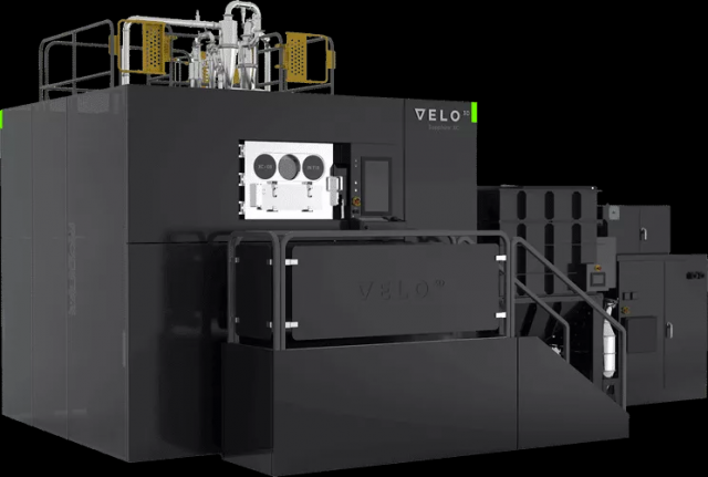

We're going to a trade show on Thursday, we're supposed to be looking at yet another new machine on the market that will help make production more viable.

Whoa, serious equiptment
Delorean Time machine ain’t got nothing on you.

Another million dollar machine?

$5M initial, one machine, 5-10 required...
I don't have the beach balls for that and that kind of money. GL.

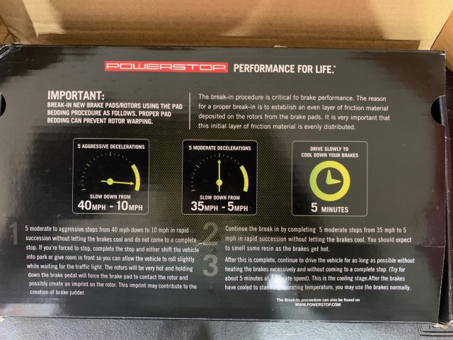

Well I drank the Kool-Aid and ordered the front and rears off Amazon, $150 shipped was pretty good I thought...
...and since it was asked (and answered) I figured I'd post the exact bedding instructions right off the package:

My .02, and only my .02
Flip this on its head a bit and then tweak...
40-10mph, 10x @ .3-.4gs (use your Uconnect)
Cool down...
then
60-20mph, 10x @ .6-.8gs, nearly as quick as you can knock them out, BEING ACUTELY AWARE OF IMPENDING FADE!!!, STOP BEDDING PROCESS BEFORE FADE SETS IN!
Complete cool down by driving, no complete stops during cool down unless required for law/safety...
Rinse/Repeat if you're unhappy with stopping performance...

Is this for making brake pads??

That is a DMLS printer, what you make in it is up to you, for us, we are printing our rotors in a similar machine, but are strongly considering this one, because reasons....

I had no idea what you did! You guys making rotors? That’s awesome! So not sure what the dmls stands for without google but guessing metal additive printer or something of the sort. You guys print whatever in volume by contract?

DMLS is a somewhat generic term in the AM industry, "Direct Metal Laser Sintering"

Ah, you zap the powder material with lasers, that’s awesome I think Ferd did this for their intake manifold o NBC the gymkana mustang. Those things look awesome! Cheaper than stock ones too?? Amazing!
