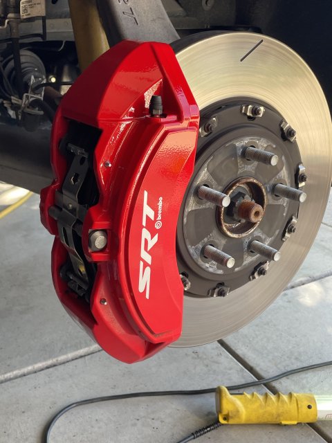

22' Super Stock, 1450 miles. I changed my front pads to the Z26 last weekend. Purchased from Amazon.
Install took about 20 minutes per wheel. Rotors were perfect as expected from a nearly new car. I put about 30 miles on the car this past Saturday and spent most of the time bedding the new pads. After the 30 miles, nearly zero dust. Braking feels as good as factory.
I'll have the car out again next Saturday and will update after a few more miles. The car is used for spirited street and 1/4 mile drag racing.

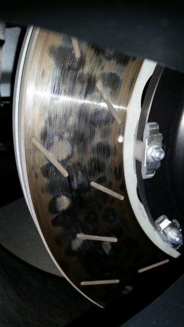

Z26s on O.E. rotors used for the Colorado Mile.
Oops.
