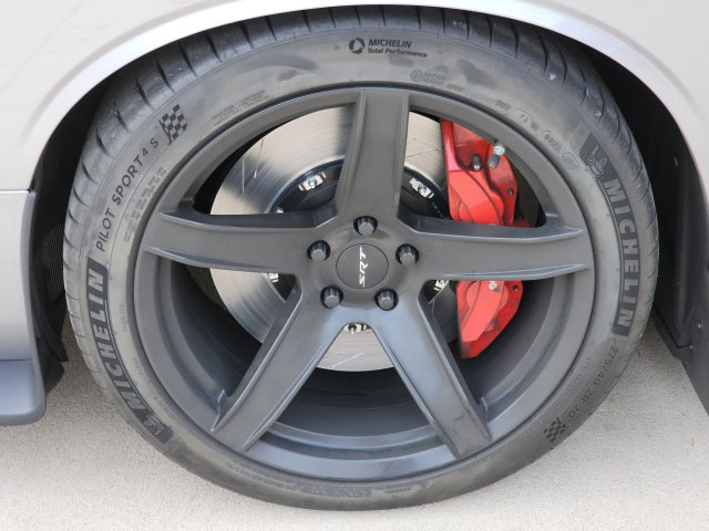

I'm sorry guys, I know this has dragged out forever. : (
It's tough working a multi-million dollar problem on $100ks budget, but we're making progress.
This was more street testing from Friday. (Note the heavy dust)
5,210
9,669
I'm sure it's not easy going from ground zero to full production and very expensive.
You're still my hero @BULL. I wish the best for you for all your hard work. One day you'll get all your money back and then some. Looking forward to that day.
