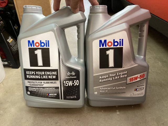

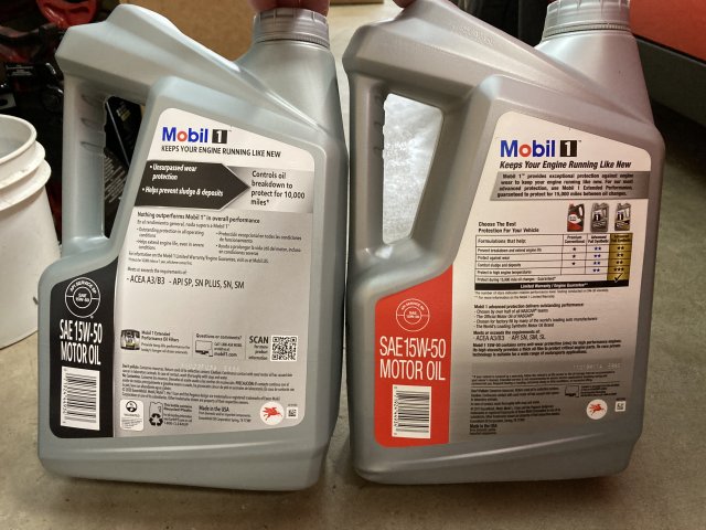

Im seeing about the same, I’m running 5W50 but next oil change going to 15W50. I’ve seen 225 max oil temps in 80-85 ambient even after repeated 1/4 runs. I run E85 and after running the oil for 5-600 mostly hard miles see a 5 psi drop in oil pressures idle to WOT, change to fresh oil and pressure is back. Oil tests do not show a viscosity issue or a fuel contamination issue. I just don’t know why this happens. Is it normal? I’ve heard such is running ethanol? The Mobil 1 15W50 I’m going to try has the same 100C viscosity as Valvoline VR 20W50 but a much thinner cold pour numbers then the VR. But check this out, there’s 2 types of Mobil 1 15W50 synthetic oils, the racing version has more zinc and not as cat friendly and I’m still running through cats so I will be trying the black label first, has about the same goodies as VR.

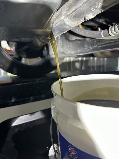

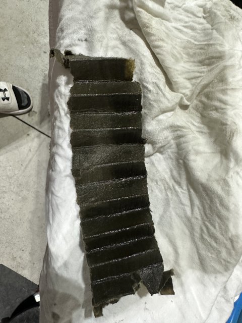

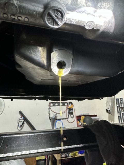

100 mile break in done! Not one spec of metal in the filter or oil! It’s go time! 😈😈
