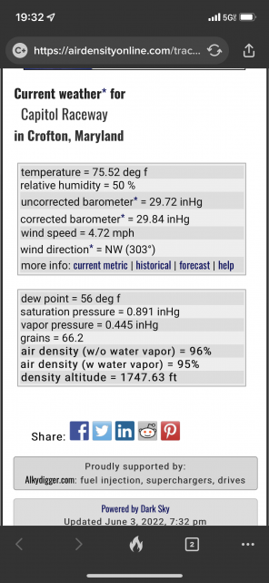

The air is not that good, saw 21-22 at max. I've definitely exceeded the airflow model. Car turned off on a hell of a rip. Coasted to 9.7 @ 138 with a 1.3x 60', she was scooching. So fugging pissed.

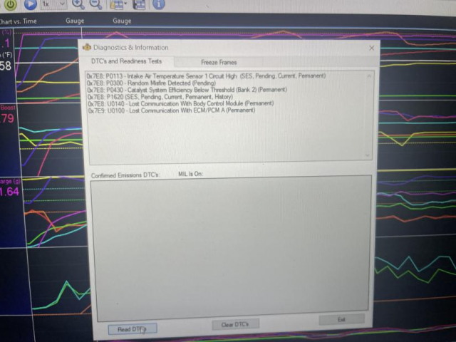

Hmm maybe missed a table. I’ll post a few tables later for you to check.
I think I sent you the engine diagnostics ones but did I send you the ones in the engine tune?

I don't think it's related, but I do see your INJ PW increase above 6300rpm and fuel pressure begins decreasing at the same time going from about 80psi down to about 71psi. It's not causing the bypass to open that I can see, but that's something to keep an eye on as you're taxing the fuel system. I'd add the pid "desired fuel pressure" so you can compare commanded to actual. Mine is always 80psi for both and fuel pump duty % never goes over 85%.
