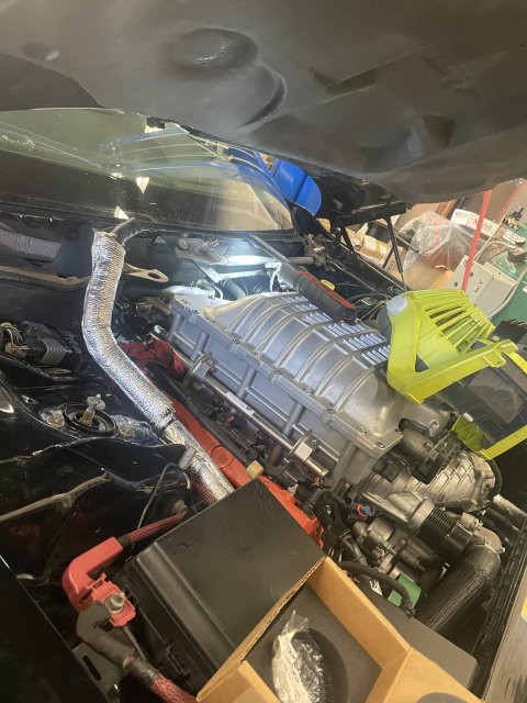

Lfrx7’s are in. Car idles so much better… wonder why…
Out with the old…

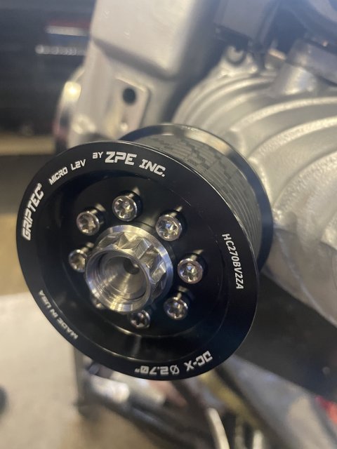

griptec makes a solid product

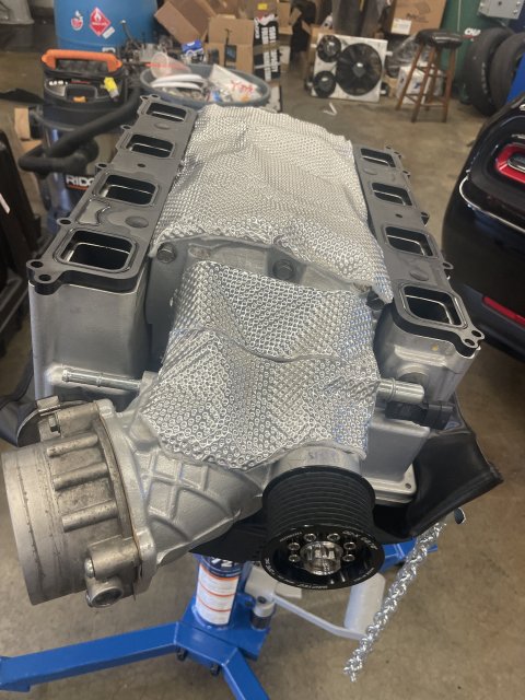

put back on my spacer plates and put a new heat blanket on

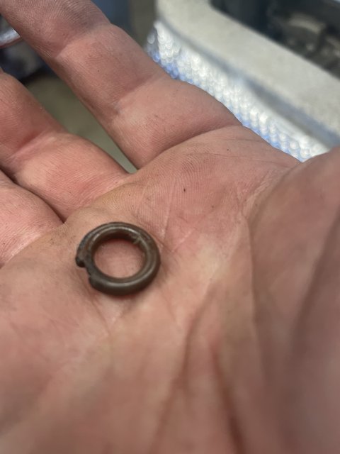

mike found an oring that needed fixing, he recommends lithium grease as I told him I used oil, he says oil can make them expand in a bad way

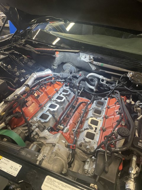

it looks lonely in here

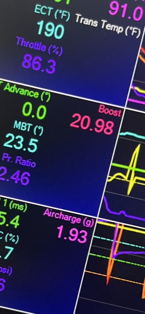

in that quick little WOT. Was only .59 lean. Going from a 2.72 to a 2.70 requires marginal changes! Now I just need @jonx96 to sell me a 2.6x, lets go!
Out with the old…

Where’s that oring from?

Oring was from the injectors. We inspected them. Seated in the S/C. Glad we found it. Next test n tune is this week hopefully.

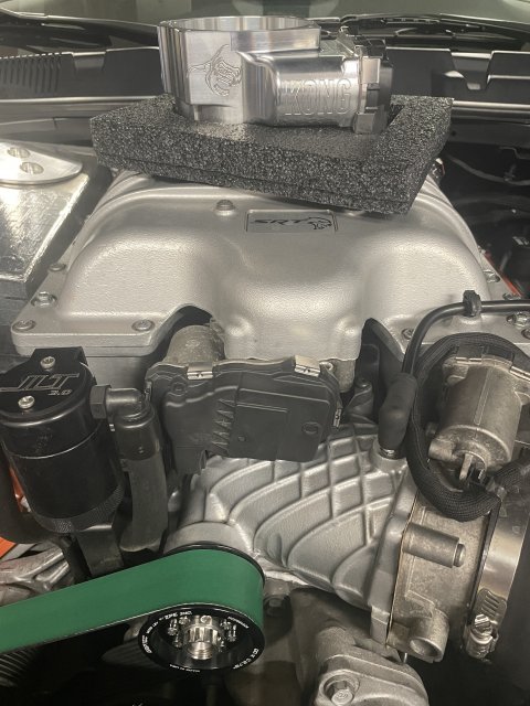

The TB is physically attached. I did a throttle re-learn from VCM scanner. If anyone is running a 108mm throttle body from Kong, can the disclaimer on their site with “No tuning” required be correct or is that for stock applications only?

I have 0 experience with one but a 108 seems fairly big for no tune required. Just my thoughts I could be wrong. I'd think if you tuned for it there would be more gain than not tuning for it.
7,473
19,638
Maybe. It's air flow right? So since these cars are wideband all the time the fueling can likely adjust for the TB. You have 10%+/- of fueling adjustment that won't be any problem, more than that I'd want to adjust it. Won't throw a code until +/- 30% though if memory serves.
If the car doesn't have a freak out at idle then maybe it is plug and play. Personally I'd wanna dial the fueling in though just because.
Historically if the TB was a problem for the tune you'd get some surging and up/down rev all on its own at idle.
Looks awesome Fuman !
I think you would want to fine tune it with all the changes that you made.

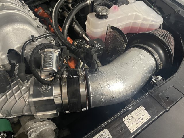

One tid bit that I noticed that I think you should insulate the coolant tank next to your air filter. That tank gets perty hot & puts off a lot of heat.

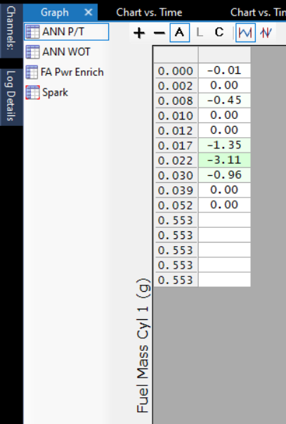

Wow, that's moving some air. How did the fuel trims look at cruise with the TB?
This is on a 10 minute drive to Home Depot, the -3.xx has existed before the throttle body, I just haven't cared enough to get it closer since it's under 5%. I've attached the log.

I do have to say I've been pleasantly surprised that this one is behaving nicely so far, I did do a quick hit at WOT and everything looked fine, track time tomrrow will tell the true tale. If I do need to make adjustments @zhc what channels should I log, right now I'm logging Sonic Air Flow.

That looks close to me. I'm curious what gains can be expected from a TB.

Imo TB alone, none, you will create a sharp edge that will create turbulence. I have a port job from Kong to match it.
