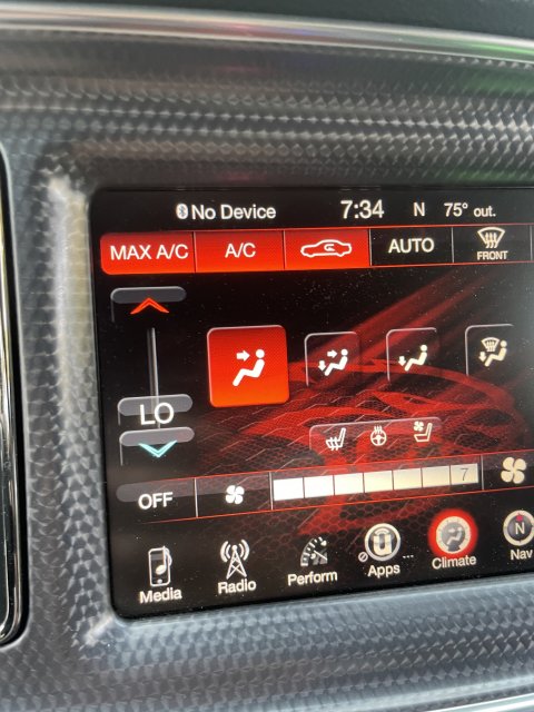

coolant flows, all valves open or close when commanded, ac blows ice cold when doing cabin…

The unit is not getting cold, however the AC blows stupid cold.

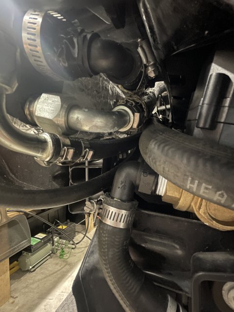

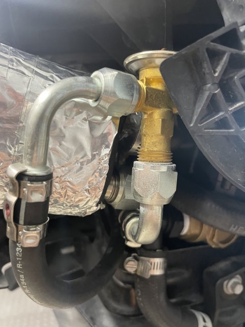

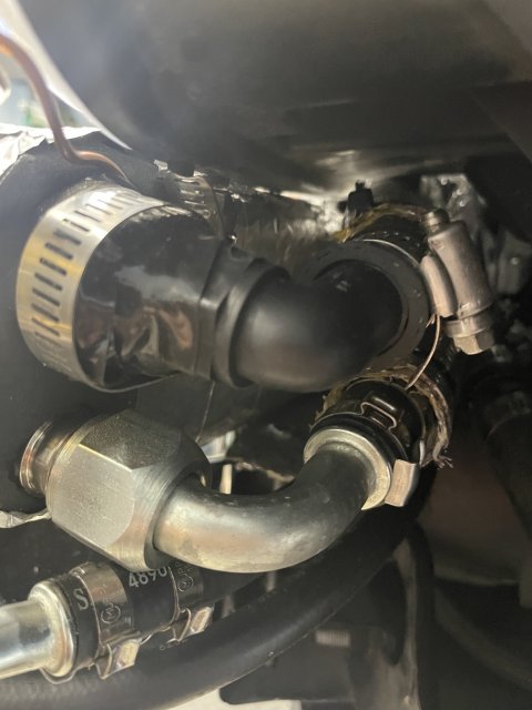

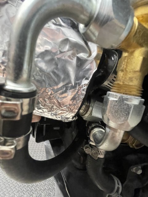

How is the orientation of the unit? Can you post a picture of the Freon in and out lines orientation to the ground? The outlet needs to be on the bottom not the top or it can fill with liquid Freon and not evaporate correctly, worst case not even flow, ie not get cold then.

It is oriented down as per Kincaids instructions.

Yea, looks right from pictures posted. Does the pipe and hose on the bottom of the TXV valve get cold during operation?
