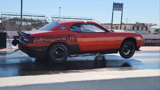

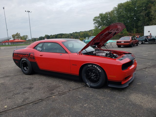

My thought wouldn't be for value going up but for actually racing it. I can't imagine the value going down being there are only 50 a year so not many for sale. What color?
This one was at my friends track rental last fall
50,054
161,651
Another pic of the car at a different track. Think you need to buy one:)

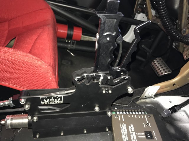

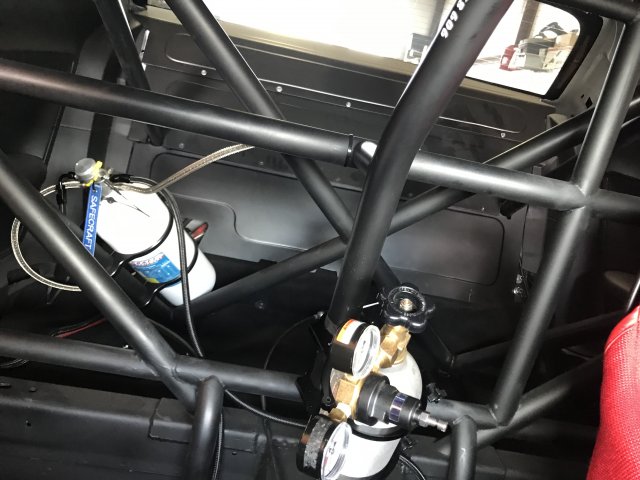

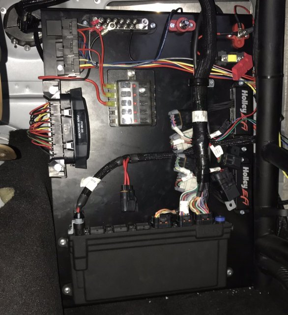

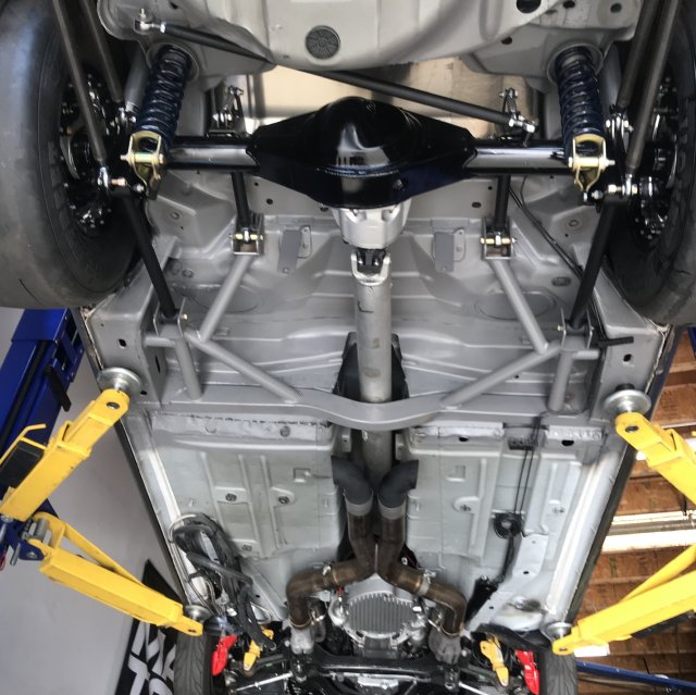

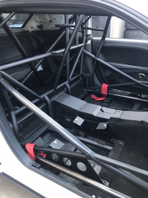

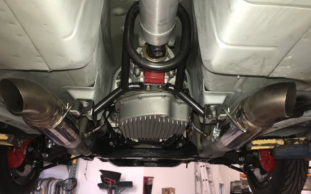

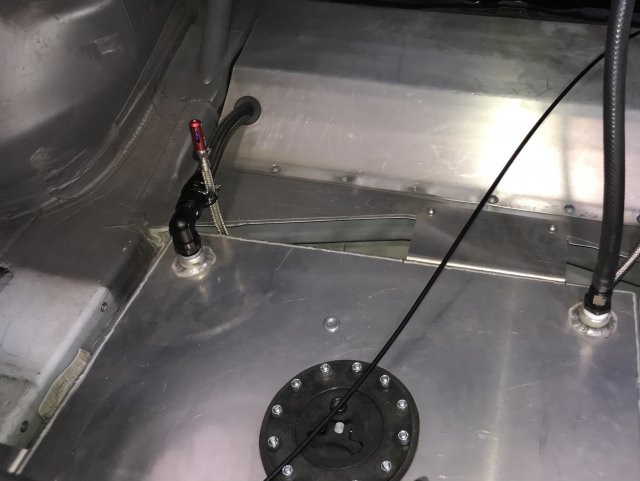

The capability to “piece one together” goes a little beyond nuts and bolts. You’re talking about a car that is going to get down the quarter in less than 8 seconds. That looks like this. There’s welding involved. 😂 DFE83803-C907-449A-9604-6E2102D1F27E.jpeg 8076BB05-7E44-41DE-89EC-12A157D1105B.jpeg 863E99D9-2878-4067-A225-819A5490815C.jpeg BF4BA5D5-062D-4109-9398-FAFA276F10BE.jpeg 6CE596CA-DA02-4C66-BA98-E02071686A2D.jpeg 07DC5380-3C36-41F7-B9FC-3AB8916EB3A5.jpeg 176ED680-1B03-45F0-857A-1F13BAB6A878.jpeg

It freaks me out to see a unibody designed for IRS with ONLY solid axle in it.
Almost naked looking.
3,307
10,517
Haha. 300 lbs worth of clothes removed. There’s a lot more to that solid axle then initially obvious. There’s no attaching that stuff to the “unibody”. The entire Chromoly roll cage/structure is the new triangulated foundation for that rear end and suspension. From scratch you’re looking at over $40k to do that including the suspension and rolling pieces. That’s if you can contract the necessary shop skills and time at a “reasonable” cost. Good luck
