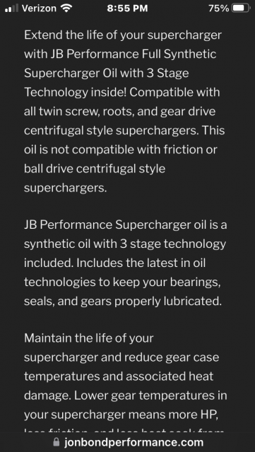

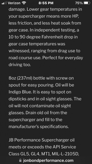

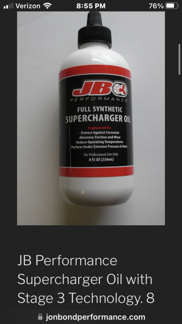

Agree, but I think he offers pinning the couplings on his rebuilds, wouldn’t hurt to ask on that, it’s easily done before adding the bolt's. Jon Bonds blue ceramic blower Lube is pretty good stuff. Don’t know what they use but Personally I’d use JB’s. It’s proven to lower gear case temps considerably especially in over driven applications. Best applied to a cleaned out gear case, ie after cover was removed and interior washed out with brake cleaner and cover put back on, fill with 6 oz’s and done.
https://www.jonbondperformance.com/product/jb-supercharger-oil/
