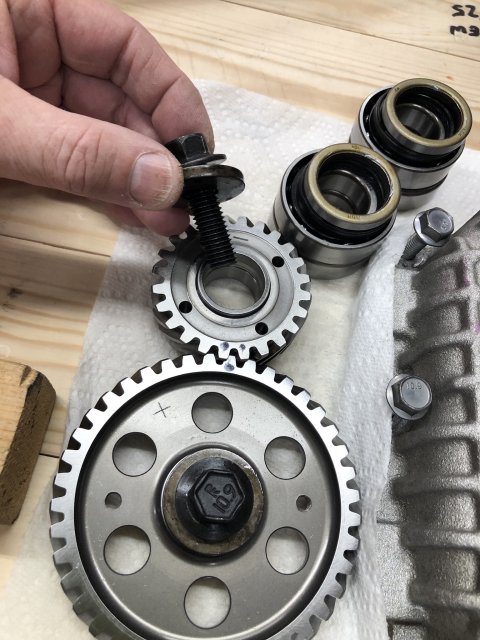

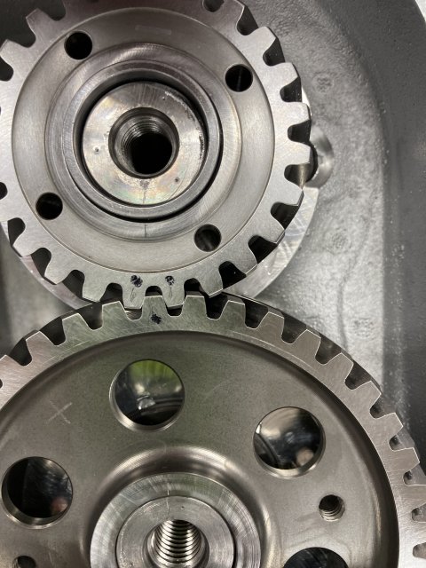

Nope, it has a little ring that squeezes between 2 faces, not even a taper lock kind of lock up, just face to face clamp load. I put 680 lock tite in there and be quick about getting timing right and lock it down with an impact. Never had one move after that. I’ll post a picture in a bit of it, Have to find one on my phone. I posted pictures of the area before it’s probably in that thread that speedy posted a link to earlier in this thread
3,774
8,924
#72

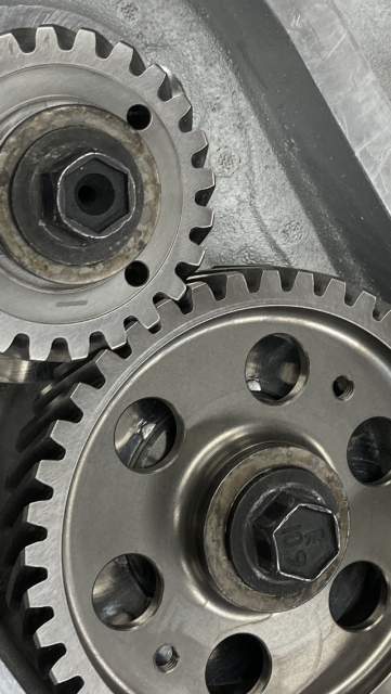

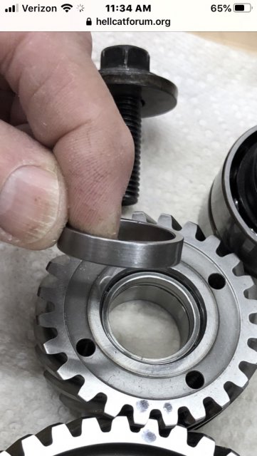

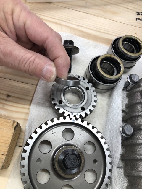

This little ring sandwiched between bolt and gearbis all that hold the faster gear on the heavier faster spinning rotor in place. And has to keep this .006” cold gap, which probably closes to .002-.003 when the rotors are hot, from touching. They get out of time just a hair and they start rubbing the coating off first, then comes aluminum if they get further out of time and then they start getting hot quick and then lock up against one another and blow the case apart. The weaker 2015-2017 cases with out the cylinder separating ports fail first as they are very thinly casted.

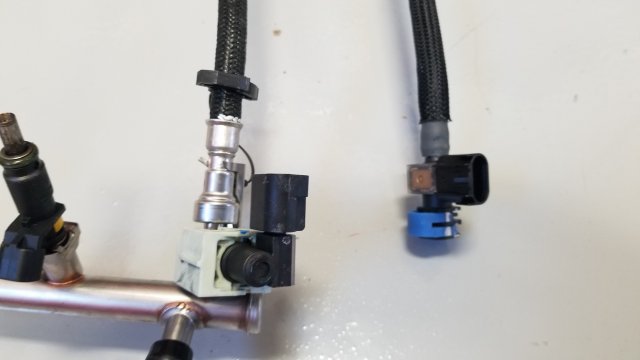

I plan to use the RE fuel rail since it has that nifty Schrader port on it. Will come in handy if I need to swap fuels for some reason.
What I believe is the fuel pressure sensor looks a hair different. Still a 3 prong so it'll plug in to my 2016 harness on the car, but anyone done this and know it's just plug and play? 2019 RE on the left, 2016 Hellcat on the right. I tried to look up the numbers on a little decal on the sensor but even Google had no ideas.

#75
View attachment 74566 View attachment 74567 View attachment 74568 View attachment 74569 View attachment 74570 View attachment 74571
The actual clamp load is the flat washer on top of the "Spacer" bushing that holds the spacing, I agree that it is a tremendous load for such a small bolt to hold with that kind of mass and inertia...I personally would use a 12.9 for the added insurance.
3,774
8,924
#76
That’s precisely what I do, I upgrade all bolts to 12.9’s but finding a grade 12.9 Flange Head LH thread bolt center drilled and cross drilled is impossible. This is a pretty special bolt. The blower gear case breaths to atmosphere through this bolts center.

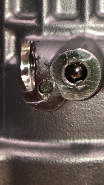

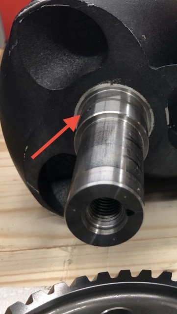

#77

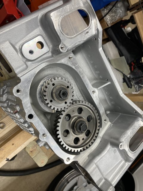

See the funnel shape leading to the hole in the bolts center? Centrifugal force at 25,000+ rpm separates any oil in the maelstrom of swirling oil from getting out the hole but air pressure differences can. It leads to the hole in the shaft pointed out by the red arrow which leads to a chamber between 2 seals that leads to the 2 vent ports on the underside of the blower. (Not the shinny ball, the porous looking things to the left of the shinny ball). These are the things that you don’t want to cover up when you put a blower blanket on the bottom, cut little slits in the blanket so these 2 ports can breath

#80
View attachment 74723 View attachment 74724 View attachment 74725
With the second picture being so close, I'm having a hard time seeing exactly where this hole is relative to a thermo blanket install. I ask because both my cars have the spacers and the thermo blanket installed.
