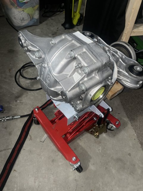

Seems the axle is in there good, the splines are twisted. It is Sunday, I don't want to work on the car so it will sit. Just sitting here myself before my morning coffee and thinking about how disappointed I am in the GForce axles. These are supposed to be the Billy Badass of axles but yet they can't even hold up for my car. It also has me borderline depressed cause I already took all my vacation this year and spent it on MSHS events, planned hotel booking and travel, made sure I had a dog sitter, etc.. and here I am looking at another 2-3k for a diff and replacement axles.
And it couldn't have happened at a worse time as I just dropped a sizeable chunk of money on the car, to the tune of ~20k for something very big that I don't want to reveal yet but will be discussed soon. Just all around shitty end to the weekend. But hey that's racing. Do me a favor, like, share subscribe. Need that Youtube money before I start an OF for the cougars/snow leopards that need a strapping young pool boy... 😂

Have my old demon axles. Just got new demon axles as well. Didn’t realize DC power broker was right down the road.
New diff is coming, have a backup diff coming and the old diff is coming out of the car. Going to save my pennies for a TBA. Also have my 2.62 diff laying around.
so four differentials
three fucks left
two sets of axles
and a set of broke bitch gforce axles in a pear tree

You win some and you lose most of it. Had a long call with GForce. Im going to keep that conversation private till the axles are inspected.
UPS lost my 3.09 in the mail, the new new that @Hatermkr just put together for me. Its like the Devil doesn’t want me to win. Its very depressing.
Onto the good news UPS manages to only fuck up this order half way. Another Diff was shipped, had very distinct this side up arrows and then was reboxed upside down and fucking diff fluid everywhere. After some simple green abd brake cleaner she cleaned up nicely.
this unit is used, will get flushed and then boroscoped, this will be my backup.
