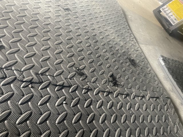

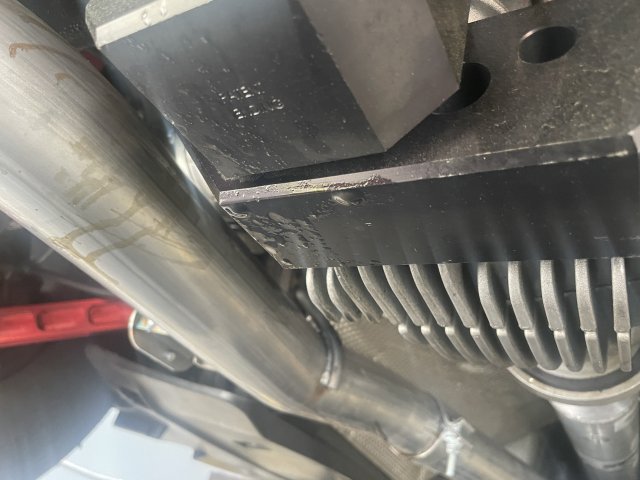

RIP diff, you will be missed. Based on the fluid Im either guessing the axle broke or the diff shattered the seal. Place your bets below on what it is. Ill post a teardown around 3PM today. Under the car doing an autopsy as I type this. Also, am I fast now?

My bet - broken axle. You were able to get it home?

Broken seal on the pinion

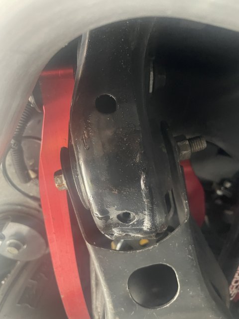

Wheel hop? Is that the best diff brace known to mankind. 🫣
No wheel hop, in the newest videos you can see just good solid launches.

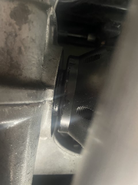

Seems the axle is in there good, the splines are twisted. It is Sunday, I don't want to work on the car so it will sit. Just sitting here myself before my morning coffee and thinking about how disappointed I am in the GForce axles. These are supposed to be the Billy Badass of axles but yet they can't even hold up for my car. It also has me borderline depressed cause I already took all my vacation this year and spent it on MSHS events, planned hotel booking and travel, made sure I had a dog sitter, etc.. and here I am looking at another 2-3k for a diff and replacement axles.

Sorry you are having these issues. @jonx96 and I found it is next to impossible to pull the outlaw axles out by dropping the rear. The stock axles and renegades will come out that way but not the outlaws, there isn't enough give in them. We ended up damaging both boots and broke something inside of one Jon found out when he sent them back in for boot replacement
They must be using some soft alloy now since you and @Hatermkr both twisted the axles splines
