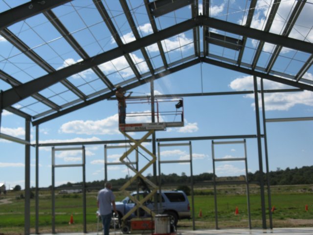

They are one reason I abandoned my initial idea about having a more open and airy design, should global warming make those critters eventually come over here. Well, that and snow. IMG_2805.jpg

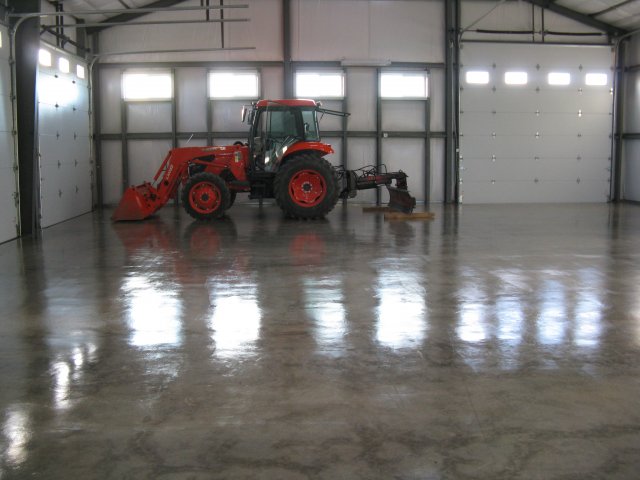

Decided to sacrifice some some of the natural lighting and went with a roof, walls, and higher windows instead. IMG_2915.jpg
