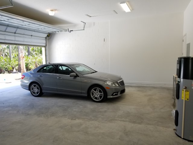

Just got home. Here's what it looks like with cars. It's packed. I recommend more width, at the minimum.
If I could fit 2 cars in there with enough space for equipment and workbenches I’d be happy haha
