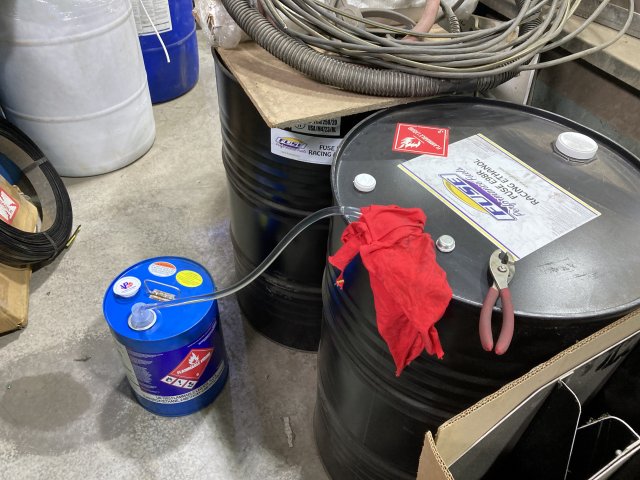

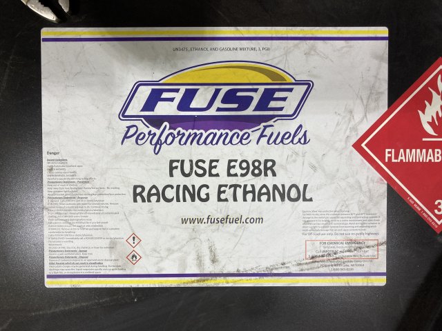

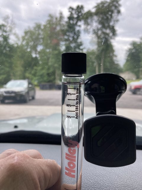

I just do this, good old siphon works just fine to transfer into 5 gallon pails, mix 50/50 with E83 for a E90+ cocktail :) A5A94E5F-9828-44C1-BCFF-8E0EC5330570.jpeg 5443BB54-ABBB-477B-BD32-3468339B03F5.jpeg DB89C8CE-66BC-4A8E-B0A3-1E012107E09A.jpeg
About 99% pure grain alcohol

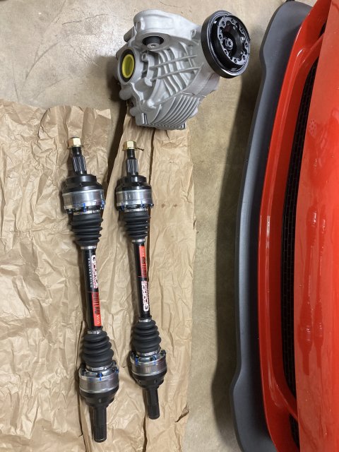

So today set up with RSG to have the tranny rebuilt with all 9310 gears in a 2.66 close ratio variety, 1400 ft lb rated in the Vipers. So now along with the GForce Outlaw axles that arrived yesterday and new 3.73 Diff the drivetrain will be 100% new and better for next time. SUCKS though as I had a Dyno appointment Monday AM to see what she was making, and do some dyno tuning, figures the E85 tune was finally getting almost completely debugged and now another set back :( These cars are parts HOGS (And wallet drainers) Here’s the new goodies, late next week on the trans.
