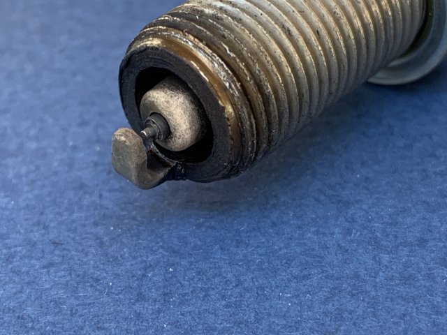

I pulled the #5R plug, seemed the easiest to access. Same type as in Speedy's vid though my gap measured .021". (Speedy mentioned in his vid his tech measured .024".) So it looks like the recall was done and the correct plugs were installed.

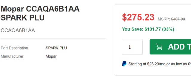

Is it correct to assume that this is for 16 plugs? Just curious. If so, not a terrible price.

You can get a set of 16 NGK 2309 for $125.
