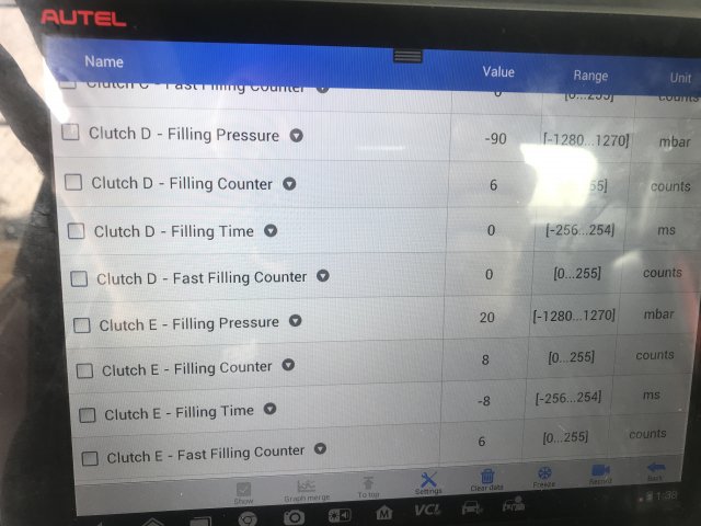

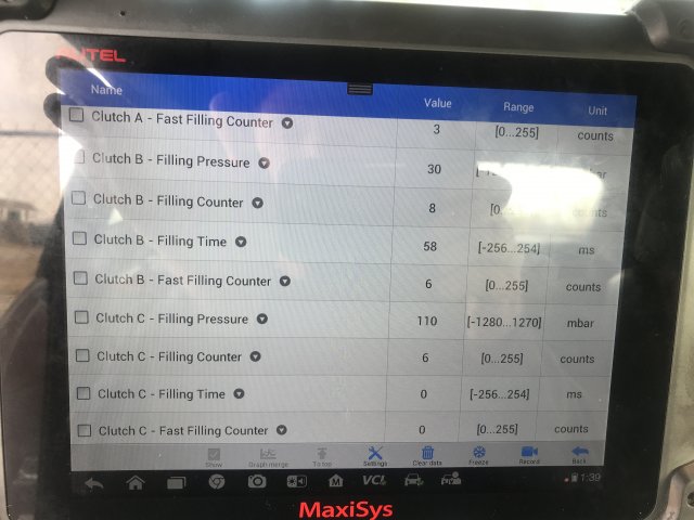

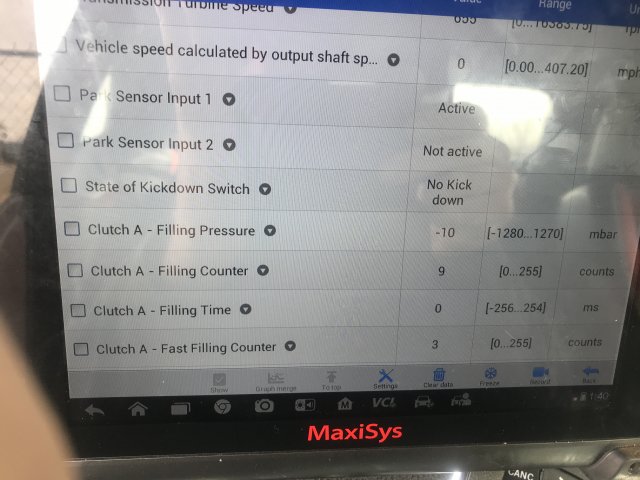

Been driving the car now since Monday and figure I’d share with you guys the clutch fill times and counters that speedy talked about 28BF6416-DE8A-44A3-A4AB-D12E7F6110D5.jpeg 730BCD33-F34C-48B5-A53E-EAA381F268D6.jpeg 46C5B741-CB69-4E0A-9012-3F3ABBE52FB2.jpeg

What scan tool is that?
3,351
5,856
Thread Starter #552
Autel maxisys

Been driving the car now since Monday and figure I’d share with you guys the clutch fill times and counters that speedy talked about View attachment 8509 View attachment 8510 View attachment 8511
No the question is how to correlate the data into a measure of performance. No doubt that the factory has min/max thresholds for all of these values - so to turn these into meaningful values is just a matter of filtering the data and plotting it.
I was thinking about how to create an XLS book to allow enough reference data to ensure when tuning there were no conflicts when manipulating cells. And then just copypasta the figures back into the tune file.

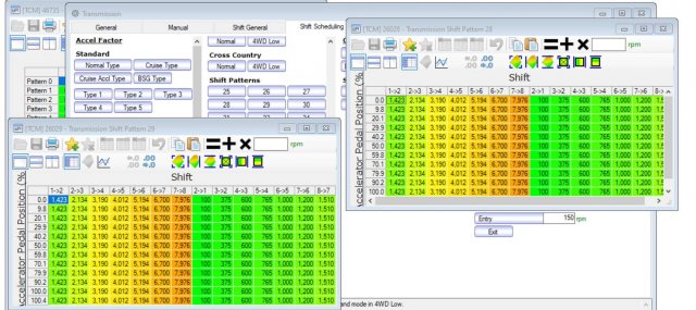

The problem is there are about 100 shift scheduling tables for RPM, aggression modifiers, etc. So you have to make a ton of changes to normalize to insure everything acts the same "most" of the time. All the time probably isn't possible but you can hone in on when paddles are in use vs not to narrow it down.

Now, someone needs to figure out when shift ID 28 and 29 are used. These are from a STOCK Redeye calibration! Found the same 6700 RPM shift points in the Demon cal as well. The conspiracy theorist in me wonders if there's some Easter egg deal like paddle down twice, paddle up twice, and hit the brake pedal for three seconds to enable these and that's how the Demon got the 9.65. In the Demon cal they're mapped to a manual paddle mode.
