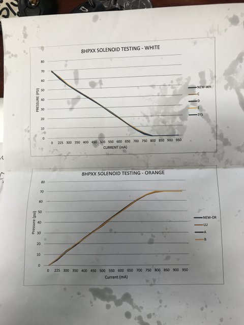

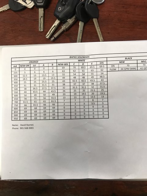

Here’s something else I was cleaning my work bench off today to get ready for another rebuild and I went thru all my clutches and steels to see which were still good and to throw away the burnt ones and I actually found hot spots on the two center steels in the C pack 🤔
3,361
5,905
Thread Starter #507
I almost forgot to share my solenoid flow test results so here you go 21FA4C73-953C-4AA8-80CC-4C28AD097815.jpeg 49724DD5-F594-49DE-98B0-36E5805779F9.jpeg
