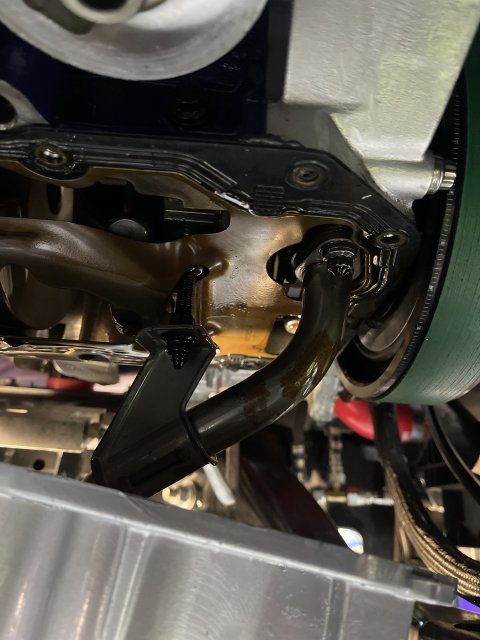

Please video lol, it would not come out. Maybe I had to dip it below the crank pulley, pull it forward a little so that the crank pulley is in the pan, push it back up flush, then slide forward. But as I recall, back was still hitting the crossmember, wrestled with it for a bit. I got it back in in under an hour

2016 helldemon
it comes out

That’s as far down as I could drop it. The back still doesn’t clear.

2016 helldemon
Yes it does. You need to rotate the crank your hitting the counter weight

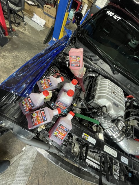

In other news have an appointment early Thursday morning. We are going to attempt the break in procedure again, without a lot of idling and what not.
What for oil you have in it?

Was asking about your oil pan issue.
Ahhhh, yes, I remember the picture, this may be even the second time I’m asking lol. Sorry about that if that’s the case. Just making sure you used a break in oil not a full synthetic oil.
if you have glazed the cylinders due to improper break in the only way to break through that stuff is to run a ball hone in it and hone it off which means you would have to drop the Pistons out. I have seen an old trick of using a powdered cleanser work to remove such glaze but not in a car with a supercharger. If it was a final last ditch effort for an engine that was destined to come out Anyways, I would be tempted to give that a try but damn that’s extreme. Total Seal makes s product called Quick Seat that is a super fine abrasive used for first start break in but it needs to be applied by hand to the cylinder walls before putting the pistons in, but it’s a similar concept to using a cleanser in a running engine. I wish there was something we could do to help you out of this pickle. Tough to watch a fellow hellcat brother in pain and feel helpless to help.
