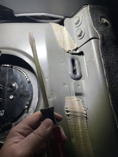

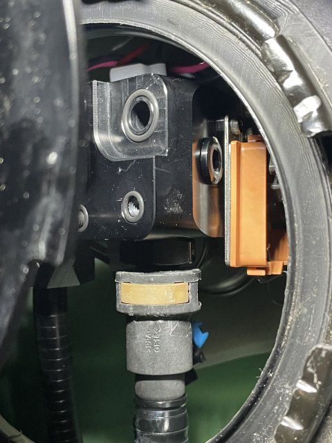

Taking bets now… broke clip or im a dumbass and didnt seat it.
4,114
10,330
Thread Starter #142
So good news, fuel pressure is normal again.
Interesting news. Last night while finger banging it into position it must have gotten past the lip. Today while in there channel my inner Hulk I could not get it to come off. Pressed down hard as hell and even tried prying it with a screw driver and nothing. I cannot fathom for the life of me how it would have come off if it was seated correctly. I'll take the blame on this one however I can't see how I did back to back passes with 80psi of fuel pressure and then when the car is off, poof...

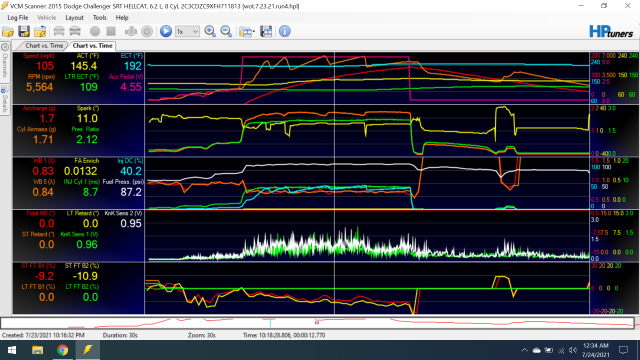

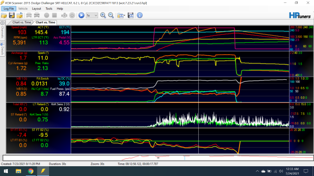

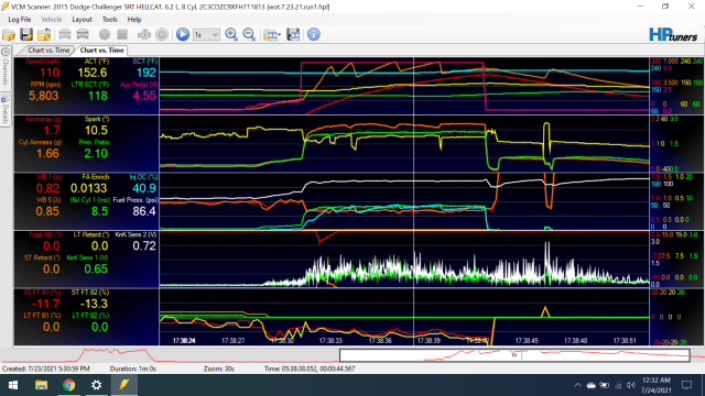

I'll post my 4 passes so you can compare. I'm car # 1127.
View attachment 49820 View attachment 49821 View attachment 49822 View attachment 49823
That's not going to make me depressed at all... I am not finessing it. I am power breaking at 2-3k rpm and dropping the hammer. You'll see in my video that I post later (currently editing). Tire PSI is usually 18PSI, a friend recommended I drop it to 16PSI.
