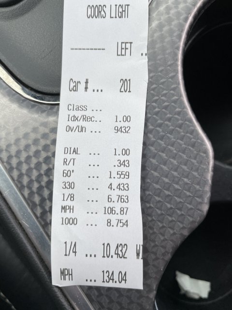

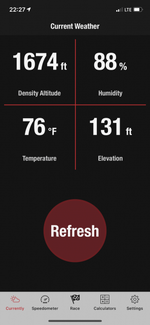

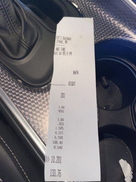

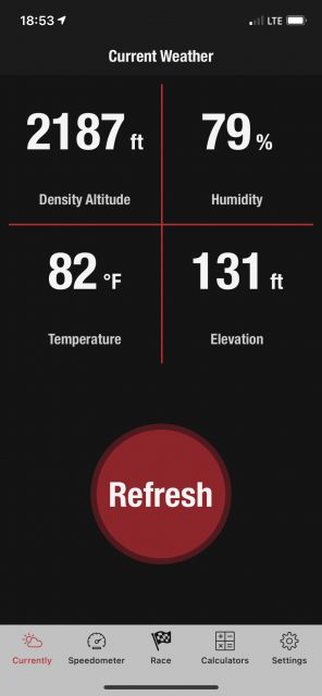

So you want 9's but mother nature says no... So I went to the track on Sunday, got ample heat and sunburn and some times... Wasn't impressed with how the car ran, best run of the day was a 10.2. The weather was not great to run in, the car was just getting hot in the staging lanes (maybe I need an active interchiller from @TrekGTO, call me fam!). 100% not @ostmike fault with the tune at all, the logs looked great, no knock up until run four. I didn't feel like battling heat at all or recording video, also cooked the gopro on the outside of the car. :( Data for the day:
I noticed in all four runs, fourth to fifth gear the BAP just stops, says no more fam, goes to stock pressure and then the injector DC rises to compensate. On the fourth pull developed -7.5 STKR, nothing dangerous but I am done with it, not risking the biscuit and going lean and going boom. Literally every friends car went... Here's the damage list:
  1. Orange Hellcat Charger running 104 with a 2.85 and Diablo -> went boom. Might need a short block, HHP will be diagnosing.
  2. Widebody ScatPack running E85 with built bottom end and procharger and Diablo -> yeeted the transmission. Sipple will be fixing this bad boy, Sipple is A+.
  3. Scatpack running E85 and a 91mm borg warner on HP Tuners -> broke axles trying to launch. He's the master mechanic at Bayside Annapolis, he can fend for himself...
Apparently @Hickster didn't sacrifice enough Floridian's this weekend to appease the racing gods...
On the way home I didn't realize I was running the HOT tune still and the car was not happy, pulled over and tried to flash it and it wouldn't flash. Said a prayer, disconnected both the Tazer and the HP Tuners dongle. Re-attached the HP Tuners dongle only and finally went back to the regular 93 tune. Drove home got some Taco Bell and played with doggo. This morning ordered the https://shop.ostdyno.com/shop/shop/...dyno-hellcat-dual-fuel-pump-system-plug-play/ and https://shop.ostdyno.com/shop/shop/...systems-hellcat-demon/hellcat-fuel-drain-kit/ to address my fuel issues and requested a full send 104 only tune. I'm over this, I want a 9s hellcat and then I can stop with the madness. Sorry for not having a good video but my friend got a good video of me, the car was leaving like a freight train, just DA, Humidity and Grain size play a big part. For 93 with a big splash of 104 and no broken parts, I'll take it.

You been doing this long enough to know when the DA goes so do the times

100% correct, I’ll take my 10.2 and be happy.
