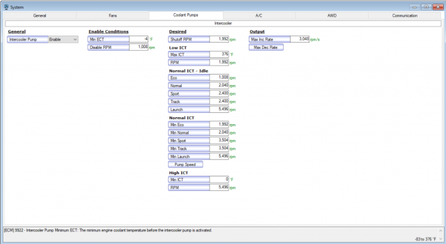

Hehe still working on it, had more 93 in it than I thought. Im swapping fuels tonight. Learned I cant use the OST kit anymore cause the BMR tank is in the way. Have to use a transfer pump from the back seat lol.
In other news, learned track mode pushes the IC pump a lot harder…
She was frosty. Imo im going to look at the tune and copy the settings to the custom mode.

In my tune the track mode & sport mode is set to run the ic pump at the same speed.

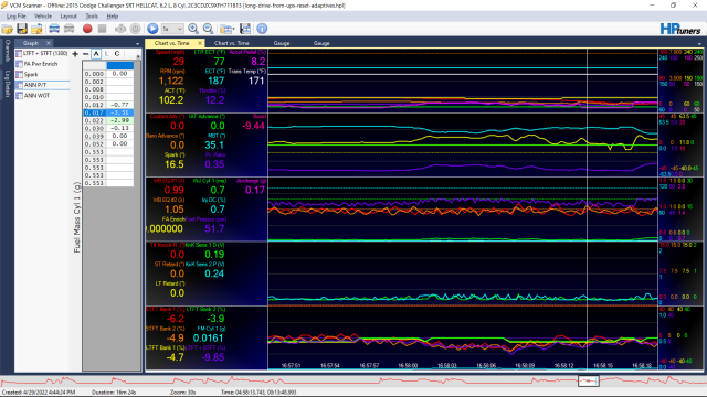

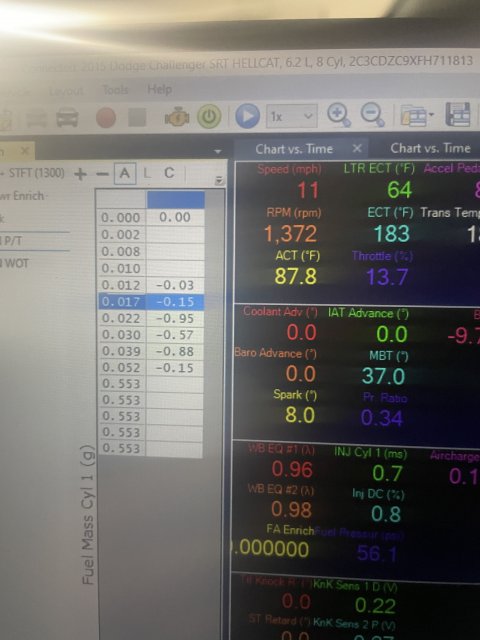

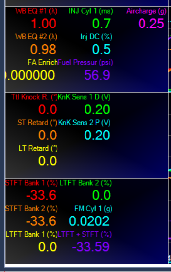

C8AE601C-0B84-4704-901E-1C97F7EF43B7.jpeg 0C534FB7-D040-4FA7-89DD-478E346ABE8D.jpeg So I do have a question about the wild LTFT AND STFT... Is this because the car was calibrated for 93 octane and that's what it's reporting like massive numbers in my logs?
I've attached the logs so any peer review is appreicated. Also is there a channel to log for inferred ethanol content or is that not a thing?
I just made those changes too.

Trims are pretty far off. I'm assuming you've got a dedicated E85 tune you're working on there and the trims should be as close to zero like normal.
That is correct, e85 only. I was confused because the wb is report 1.0 but I guess that's because the car also didn't move so the LTFT data never moved. I don't want to flood the engine...

Your trims should not be that far off if you updated all of the tables correctly. Unless there was still 93 in there.
Only way to get inferred is if you use flex.
Fuels trims appear to be keeping it at one but something is off
edit they cant pull enough to keep it at one. something needs adjusted or fuel mixture is causing it
There was some 93 in there, I tried to get most of it out last night but there was still some left in the tank. Should I try to drive the car and get rid of some and get more e85 to fill in?

This is where flex is kind of nice. Yes I would just keep an eye on your widebands they don't go to lean or rich. Go 5 miles and reset adaptives drive home and take a look.

Went for a long drive and monitored AFR. Nothing negative or bad, drove to UPS about 25 minutes away. Package shipped. Got back in car, reset adaptives. The car feels much happier now and I think whatever 93 that was in the mix has sloshed around. I will keep filling up to try and get it as pure as possible. The log looks good too.

after swapping fuels in tank, it can take 5-10 minutes of run time / driving for the mixture in the fuel tank to hit the fuel rails on these dead headed fuel systems.

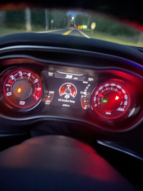

Happy to report that E85 tuning has been a real treat, so much easier.
this was a 30 minute drive and then took another 15 minute drive below. D2AD0814-582E-4E82-9F44-FA47DEACE008.jpeg
i think the 1300idx injectors just like e85 next up wot tuning
