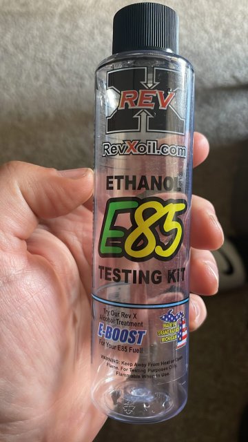

It’s time. Picking up three jugs this evening.
4,385
10,906
4,113
10,330
Thread Starter #679

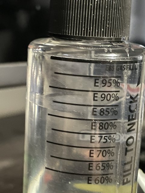

Got about 15 gallons. Testing e82.5?
60,927
212,719
about where mine has been. This week it was 85% though. I have only been using one station that is just down the road from the house
