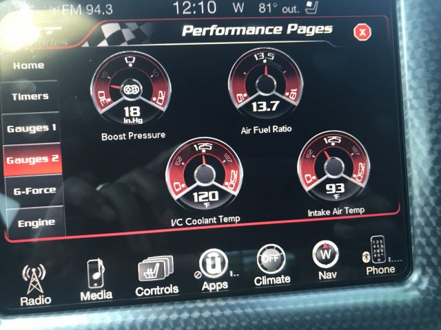

I believe that's the most current one when I checked the Uconnect update site, today. Are your IATs in agreement?
Never looked but now I will.

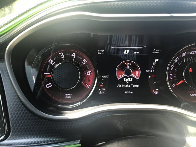

Here you go. Note the name of each is different. Back in 2015 we were told there were different sensors that fed these displays.

Yep, and now on my new unit the IC Coolant temp doesn't show at all. They've got some kinda issue there with the later OS.
