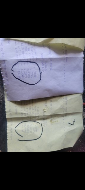

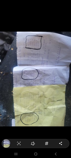

Exactly why I asked about the mph and showed those time slips where I ran high 9’s (we are yet to see the time slip to do the math). Sixty ft isn’t just about hooking up. You also need to have the power to accelerate and if there’s a issue then it’s going to show up from the top of that time slip to the final mph. I don’t see where the 134 mph number was shown. That isn’t all that strong for a modded e85 motor unless the da is real high. I think there’s more going on than just traction.
5,406
37,146
#78
until jon sees a data logged run we may never know. !34 mph is really low for the mods and with a 1.5 60 ft I would almost think it is running on 7 cylinders
Well, we all know how important it is for Datalogs.
3,500
11,266
#79
Also…. Those 9.85 times lips I showed were the first time on the track with only dyno tuning having taken place. The motor was a stock 2016 HC with the 2.4. +10 crank with a 2.65 running e85. Made 915whp. When I ran that 9.8 at 137 there was a noticeable shifting problem. It was short shifting to where it went right past 2nd gear. Afterwards the logs were reviewed and torque management was the problem. That was corrected and next pass was 145 mph. That’s what one of these should run with a pulley/e85 combo.
D
Demid22
Nurse
#15014
259
148
JONESBOROUGH
2017 Dodge Challenger Hellcat
Thread Starter #80
Slips from last night. 1/8 miles Screenshot_20230506_133129_Gallery.jpg Screenshot_20230506_133126_Gallery.jpg Screenshot_20230506_133126_Gallery.jpg
