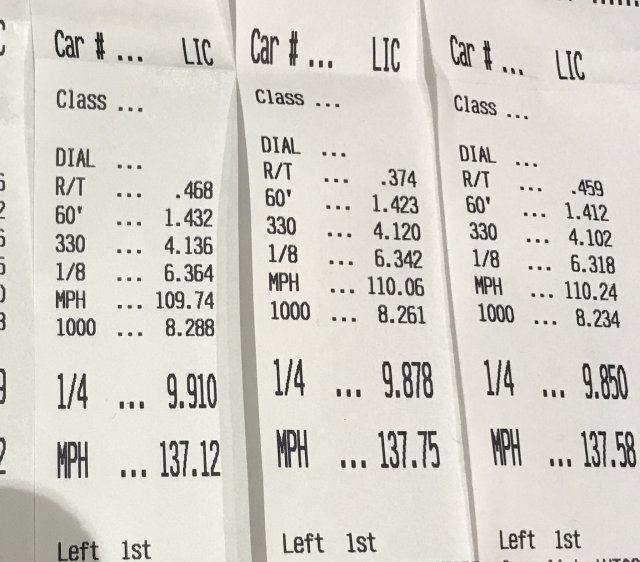

Here are some high 9 sec times slips. This will give you a look at the mph necessary to run high 9 sec et’s This was done on a well prepped track and I was running 3.09 gears with the 17” 315’s at that time. DA777280-DB3B-4999-A3A7-5185E05B6DD2.jpeg

I know i need to work on reaction time but from my understanding that doesnt effect my et or 60ft. Yea ure getting 1.4 60.ft. That's where i should be but cant seem to get it there thus the thread.
