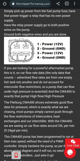

Been awhile since I updated this thread. Currently I'm on a nine day stretch on the road so I haven't had a chance to install the Whipple yet. I'll be installing it this upcoming Sunday. Some things have been brought to my attention. The BMR ice tank that I have doesn't work with the Whipple supercharger without modification. I have the stage 2 inner chiller. Does anyone happen to know what modifications need to be done to the BMR ice tank to make it work with the Whipple? I'll be going with a different ice tank soon but for now I'd like to make this work. I've also purchased a cwa400 pump along with head studs

Thanks for the advice.
A lot of people have issues with that tank. Pump doesn’t like the head pressure and makes changing plugs a nightmare.

A lot of people have issues with that tank. Pump doesn’t like the head pressure.
Switching pumps.
7,730
6,539
You can’t just switch them. It has to be ran inline
7,730
6,539
So you have to have pump on a switch (possibly tuner deactivate cels) or run pump on a switch in line with your stock pump to keep everything happy
7,730
6,539
Stock pump is canbus driven
D
Demid22
Nurse
#15014
259
148
JONESBOROUGH
2017 Dodge Challenger Hellcat
Thread Starter #337
Jon will handle the tuning bit
7,730
6,539
ok, just making sure you know it doesn’t just plug right in and there’s other things to consider
D
Demid22
Nurse
#15014
259
148
JONESBOROUGH
Thread Starter #339
7,730
6,539
As with most things aftermarket, some things are left out and it’s not plug and play. That’s all. Bmr isn’t a good product. Should go with the bwoody tank.
