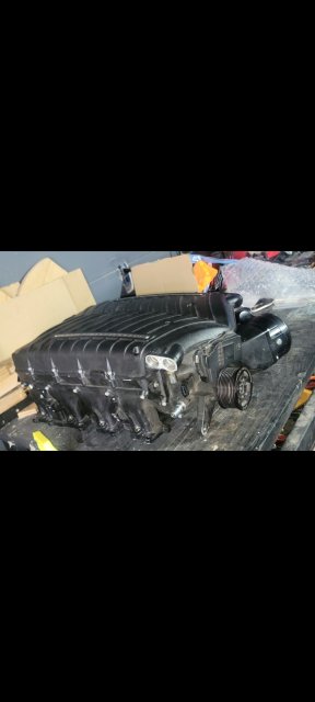

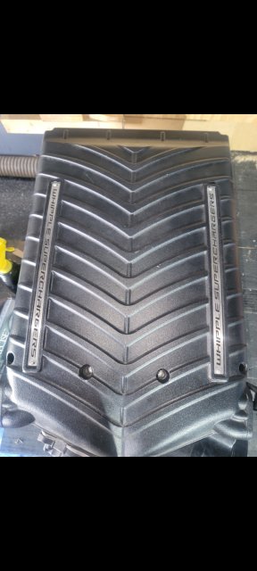

Got the Whipple. Will keep everyone posted on this build

Any advice on getting the ATI hub installed? Ive got my stock lower pulley removed but cant seem to get the ATI lower hub to slide onto the crank snout
55,934
189,512
I have heard of some not fitting. I think it says in the instruction about measuring it. I guess there must be a tolerance difference in the cranks that is acceptable

Hopefully you clean up that blower, my OCD is triggered :ROFLMAO:
Is the ATI a stock size or 10% over drive? If over drive you need to clearance the front cover.
I have referenced the post you made. This is an ati 10%
Ive already clearanced the ac bolt boss and the bolt head on the passenger side. My issue is the ATI hub will not slide onto the crank snout. I dont want to force it and booger up the crank snout.
Yes the blower will be getting a bath before install lol
