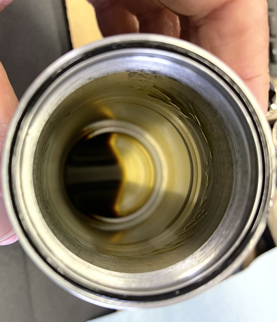

Satisfying the six month warranty requirement no matter how many miles...
I drove 1,442 miles between oil changes right at the six month point, of which about half was on road courses with lots of hard acceleration and some WOT on the long straights, and half highway and country road easy cruising between 1,500 and 2,500 RPM, mostly on the low side of that.
I estimate two teaspoons, which is .33 fluid ounces. 16 fluid ounces is a pint.
The Pennzoil Ultra Platinum oil was very dark. Here and in the drain pan.

If these vehicles required a catch can, MOPAR would install one, no?
The problem there is most would not check it. Which in time could lead to some issues.
Hell they can't even get people to check the oil on a regular basis.
16,899
52,911
#63
They DID install one.
Adding another one to improve upon what is there is the goal.
Keep in mind, the oil vapor in the pcv loop is the worst of the acidic vapor in the engine. Keeping more of it out is better.
If you're running that many miles on a road course you should be changing your oil based on engine hours and not mileage. I don't care if it is synthetic or not it still breaks down. track miles are real hard on the oil and you should consider limiting the engine hours to 15 before you change the oil. but that's just my opinion you can do whatever you like.
Good one. That is consistent with what mine looks like also.
