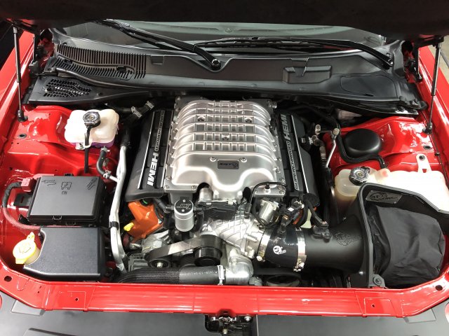

Here is a picture of my Red Eye's aftermarket UPR catch can. The PCV valve is downstream of this ventilation side catch can so it arguably stays cleaner than without a catch can. There IS an internal air/oil separator for our Hemi engines BTW. But we still see that an external aftermarket one collects oil which otherwise would go back in the intake and mix with air and fuel. That being in the ungood category.

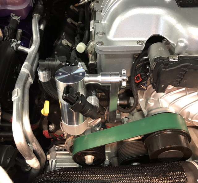

Mine does. Most folks use them on the p/s side and seem to get results with minimal result, if any, on the d/s. Here’s my JLT. View attachment 27868

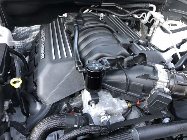

I get just a couple of tea spoons per oil change in the JLT on my ‘15. I probably run up around 2k miles per season. Maybe a bit less.
Same setup with roughly same results. Does it’s job and zero complaints with the JLT 3.0 5556A5EB-2746-4333-89A9-2938B20D5DE3.jpeg
