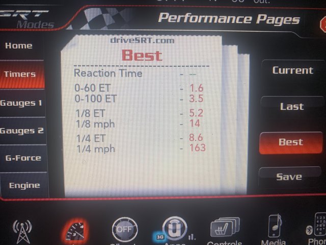

This is what my performance pages show. It’s actually pretty close.

Not as good as yours. They were 1.34x on my last three 8.6 passes. Not sure how many more my 2.62 rear will take, been through 4 years of racing on it.

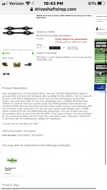

Is the DSS Stage 5 axles the 35 spline units?
These?

No. The inner stubs are smaller on the ones that are for the stock differential. I forget what the spline count on the stock axles are. 28? Z knows. Using the stock diff requires the same size axle stubs as stock. That doesn’t mean they’re not stronger. Just not as strong as mine. I hope 😂

Those are the axles that I've been using myself. It's not exactly the same as Marc's since the axles for the 9" are specific for that kit.

You get that 1/8th mph up and look out!
I ran across your times online not long ago going 8.6, just awesome!
