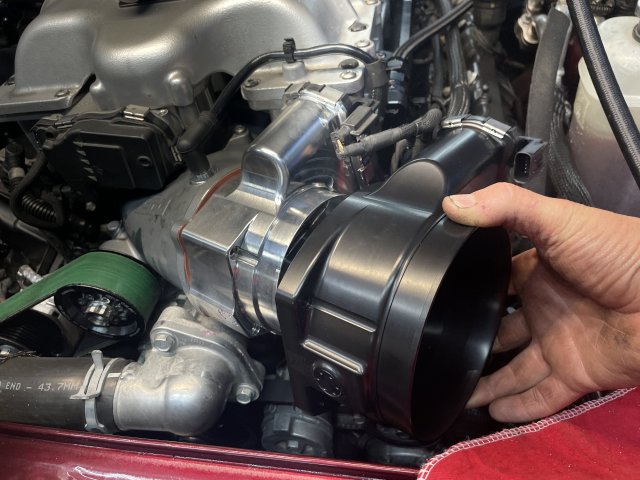

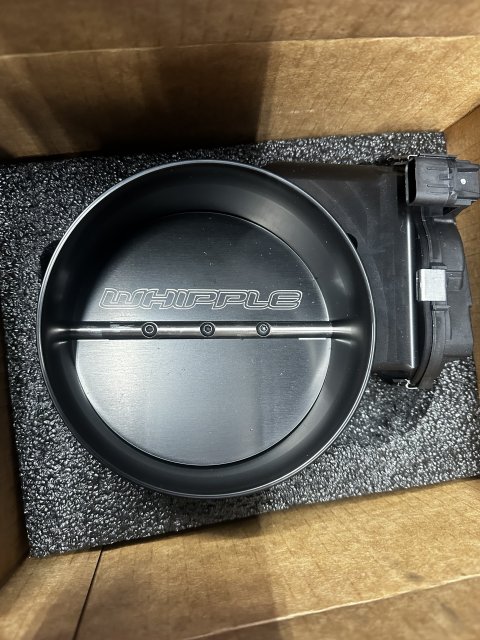

Well, getting closer lol..... Ordered from Dusterhoff. Says friday they shoud have a bunch in. Pre-paid so hopefully I get in a week or two! Wooo-hooo Psyched!

Just got email from Dusterhoff. States Nick Williams shipped them yesterday and should be here friday. Believe it when I see it lol.....

I was referring to the TB but yea its the same fit tho. I already have the billet 3.8 just not sure if im gonna use it or not right now.

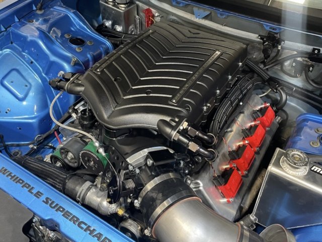

The 3.8 as a pump is simply capable of moving a lot more air than the 3.0. Case in point…. Two cars in the shop. Mine is a 426 with base Thitek Bears and the 3.0. The other car (the blue one) is a 401 with the same heads and everything else comparable. Mine was making 25 whp more at the same rpm. We traded the 3.0 on the blue car for the new billet 3.8. We were pretty much wringing the 3.0’s out rpm wise. The swap was a last minute deal for the Houston Legions event so it was kept simple without pushing it. Ran the same 109 mm throttle body off the 3.0, which with the 3.8 is limiting. We also kept the supercharger rpm conservative. There was a 225 whp increase with three pulls and nothing more than fuel adjustments. I think there will be a lot more with the 130 mm throttle body and a little more rpm. This was not a dyno race where numbers for marketing were the goal. They were just what happened when making reliable tuning adjustments to be ready to race. The current (yes there have been improvements) 3.0 is a very capable and rock solid reliable supercharger. It runs very cool (especially the DragPak version). Anyone who says otherwise is lying to sell you something else. I agree that unless you are going serious racing…. the 3.8 is overkill.

Yes. In fact from what we’ve seen, I would recommend not spinning it aggressively. It’s just ridiculous how much more power it makes. The blue car I was referring to ran a 7.84 at the Houston event. That was blower only with a big pulley and a small throttle body. That’s nuts. I ran against that thing in the semi finals at the Roadkill event Las month in Vegas and just had to watch her walk away from me. I run 165 in the 1/4.

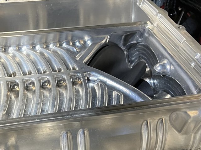

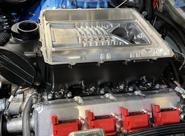

Billet version… 29FF91D8-2034-485B-9849-8908DE7A74C9.jpeg E1EBBF7E-765F-4294-AE90-44E58BB5E179.jpeg A40E6A58-D49A-43D4-9B68-5DBCE5CEDF44.jpeg

Billet version looks really nice. Do you know if the 3.8 with the larger intercooler upgrade fits under a stock Redeye hood?

Waiting on Whipple. Where have I heard that before? 😂. I have that one in the pictures for sale. It’s the billet version with the big IC and a vacuum bypass. Whipple is not making that anymore. I don’t know how long it will be before the cast version will actually be available. As far as the hood goes… I would say no.
