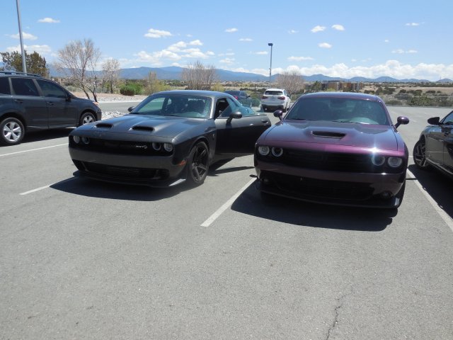

Not my 'Cat,but we used hers to go drop off her GT AWD at Carmax..
She needed to get reacquainted with it anyway, before going to Radford next week. DSCN5435[1].JPG

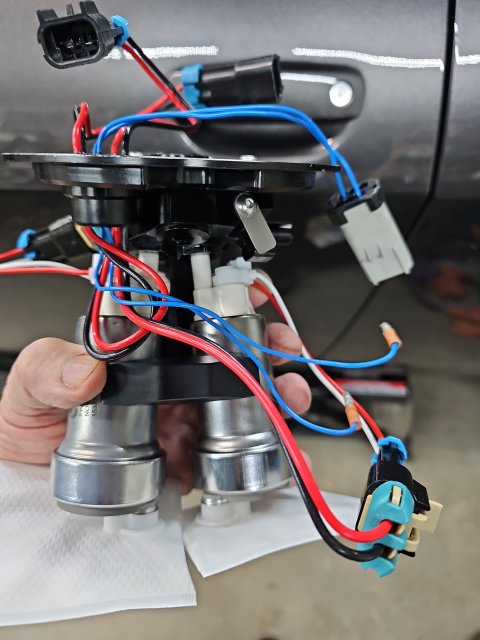

Hopefully dealt with my fueling issue for once and for all. 30b8d231-1f5c-4f70-a419-1473c94dbcea.jpg

Just wait until that starts giving you issues. Be prepared to pull it a few times
Oh great news, thanks.
I just took put the factory one that is my second one of those. I was using a JMS to make it adequate. Last time out my logs showed the JMS failed. I tried to see if it was something I could deal with. But no, connections are good, fuse is good, wires are good, the unit, not do much.
I guess I will order 2 more pumps to have in stock. They can sit next to the spare GN one. LOL

We put in the twin pumps 2 years ago I have not had to get back in there since

That's what I'm hoping for. Since I have no plans for e85 I shouldn't get into trouble. LOL

That's all I run with mine:LOL:

Mine gave me issues after 4 years. People have problems much sooner @moparjim just make sure you zip tie the wires completely out of the way of the fuel arm to make sure they can’t float and get in by the way of it. Only issues really are with the fuel level sender going bad or getting hung up on the wires, so they have to pull it to replace the card or zip tie the wires out if the way more. I now know why they say these fuel systems aren’t e85 compatible. The insulation on the fuel level sender cracks

Enjoy Radford!! Wife and I had a blast last November and hope to go back again for a longer class.
