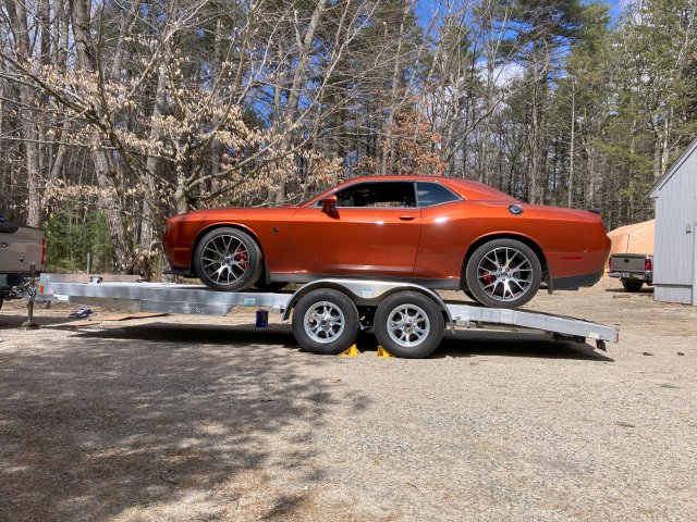

It appears that David has a very good eye. The original pic did have the car too far forward. I was checking straps today and positioned the car for 10% tongue weight and it looks al lot like the pics you guys posted. This is why I ask you guys for help, you seem to really know your chit! Thanks again! (Yeah, I know it's not level in the pics, it's on the jack. I did have to change the ball mount to one with more drop.) IMG_0051.jpeg

I want a hitch with a tongue weight gauge. That way you can adjust the load as needed.

It is a CL special. 20' Rance 7k alum trailer with an alum deck, 1350#, lighter than the trailers with a wood deck. 2-3 years old.
I only have a 1/2t, an I am concerned about pulling the car 350mi each way, not to mention some rolling hills. I ran across a 20' steel 10k tilt trailer less than a year old. It had a 12k winch added. Cost the same as this Rance. Better trailer all around, but weight was 3K# before the winch. I wanted it bad, would have been a no brainer if I had a 3/4t, sadly I had to pass.
One thing someone pointed out, if you have a trailer with a capacity way beyond the load, you will get a harsh ride. A friend transports his HC on a 14k trailer, he has to stop a lot to tighten the straps. Maybe because of the harsh ride?? As it is, I estimate 5600 on the 7k trailer, I like that ratio. In Aug I'll have better data.

I’m going to be towing with my rango r/t, towing capacity is only 7400 lbs
A WD hitch will be your friend.

This has trailer brake controls. Not far, hour to 1.5 hour hauls

Just got back from Land Speed trials, towed the HC 700+ miles with the 1/2t. So smooth and easy it was easy to forget I was towing! Part of the way was 75mph, smooth as silk! On downgrades I would look down and see 80! Not intentional.
The 10sp often downshifted into 9 on upgrades, 8 on hills, 7 a few times on slow steep hills, and 6 when I had to pass an ahole driving under the limit! Had to do that twice!!!
I had the wheels balanced and it was smooth sailing. This really was the right trailer for the car and 1/2t.
Thanks everyone for all the advice, recommendations and suggestions!
