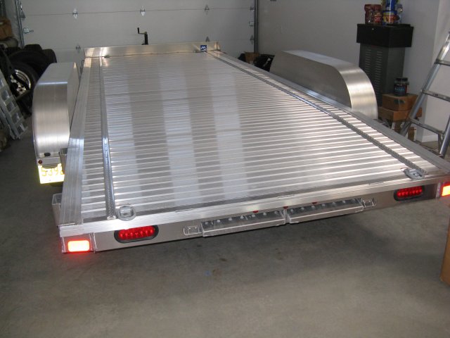

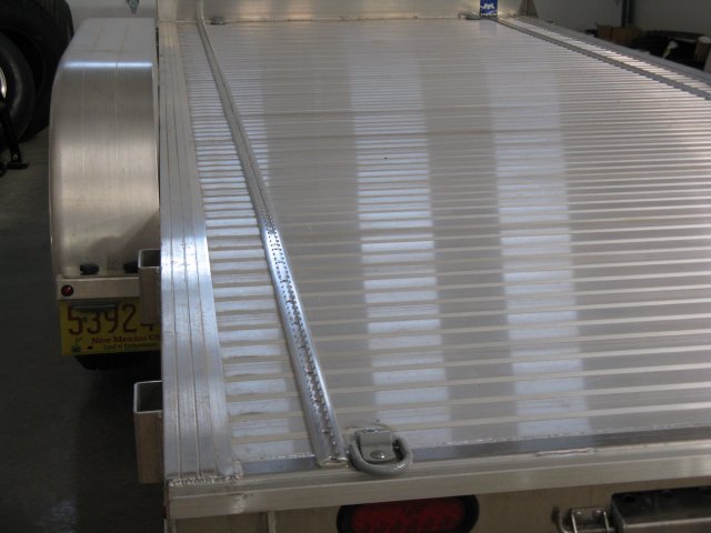

A 10K rated trailer will just beat up your 'Cat, unless it's air ride. 5,200 is ideal I think, but with an aluminum trailer 3,500 will work, just keep an eye on the bearings.
I put L-track on mine so I could use wheel nets and/or wheel straps. I'm one of those that refuse to tie to unsprung weight.

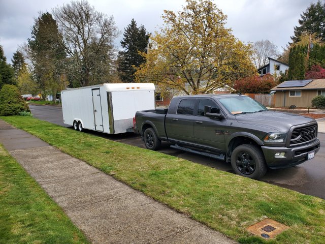

Whatever. Show us yours.
Towed 1000’s of miles, it runs down the road just great with that heavy car etc.
This is my 6th trailer. This has 2-7500lb axles. 14 years old, and the spare has never seen the ground. It's been everywhere, and on it's 2nd set of tires... due to age-cracking sidewalls.

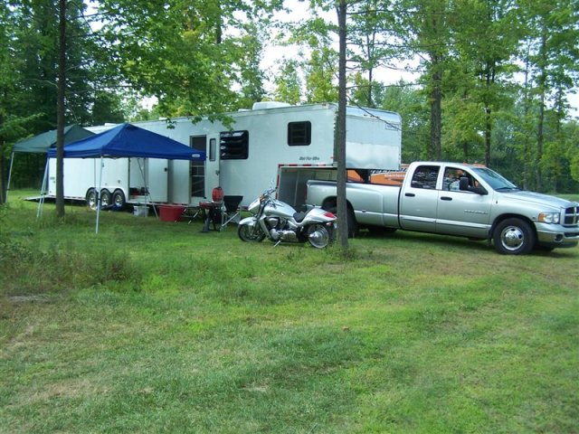

This was ungainly, but served it's purpose when I ran Nostalgia Pro-Stock.

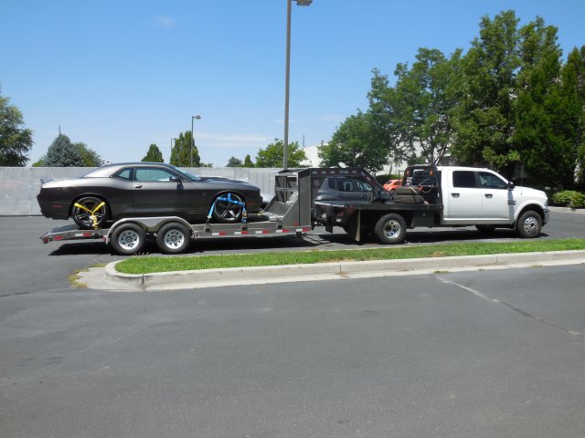

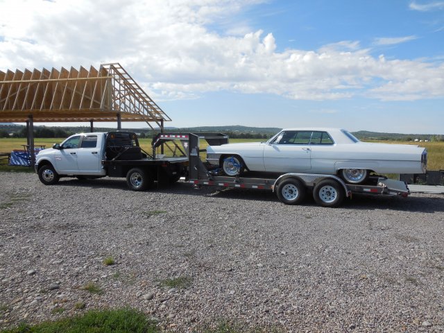

I've transported all kinds of vehicles on my 18-foot trailer, but recently decided to look into getting a 20-footer.
Well, they don't seem to make this kind anymore, so I'll either add a foot or two to this one, or simply leave well enough alone. DSCN2112.JPG DSCN2124.JPG

I like the trailer to take the hit if possible.

Yeah, that's partially what made my think about a longer one. But if you look at the Challenger on the trailer you'll see that it could've been moved forward by over a foot.
Of course, my unfair advantage is that by driving fast, the odds of getting rear ended are minimized.
Anyway, at 16.5 feet a Challenger fits fine on an 18-foot trailer. Even a gooseneck where there's a "wall" in the front.

You can see in the picture that I posted with the Challenger that it has plenty of room on both ends. Enough for additional tires and gear.

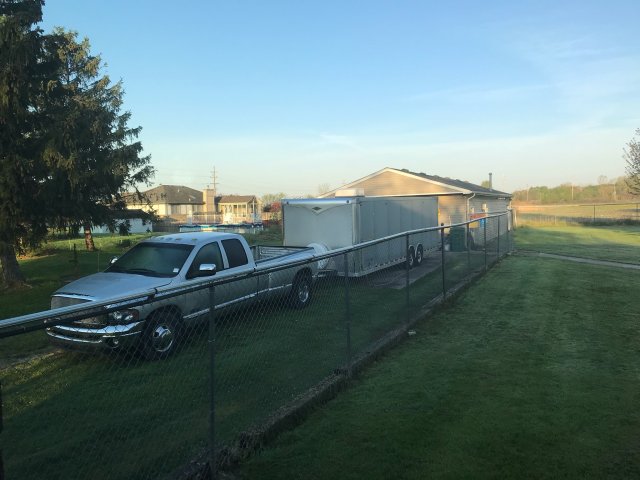

If it's a race trailer, you want to keep your gear in the trailer for faster loading next time. Cuts down on the work.
If I would of continued, it would of been built out with more comfort things.
View attachment 126185 View attachment 126186
Funny you should say that. I looked at 2 other mfr's of alum trailers and they both warned me away from their 7k recommending the 10k, maybe their spec was optimistic? I contacted Rance, they the 4500# HC should be fine. They further stated a trailer rated for a load higher than the actual load will cause a more harsh ride for the Cat. Made sense to me, but I'm only an engineer.
