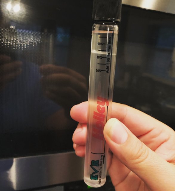

This is from the station right by my house. I just really don’t want to pay for the dual pump
7,643
20,013
Thread Starter #120
Looks just like mine.
